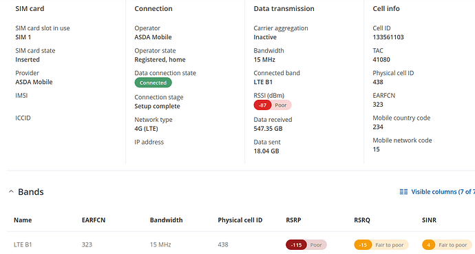

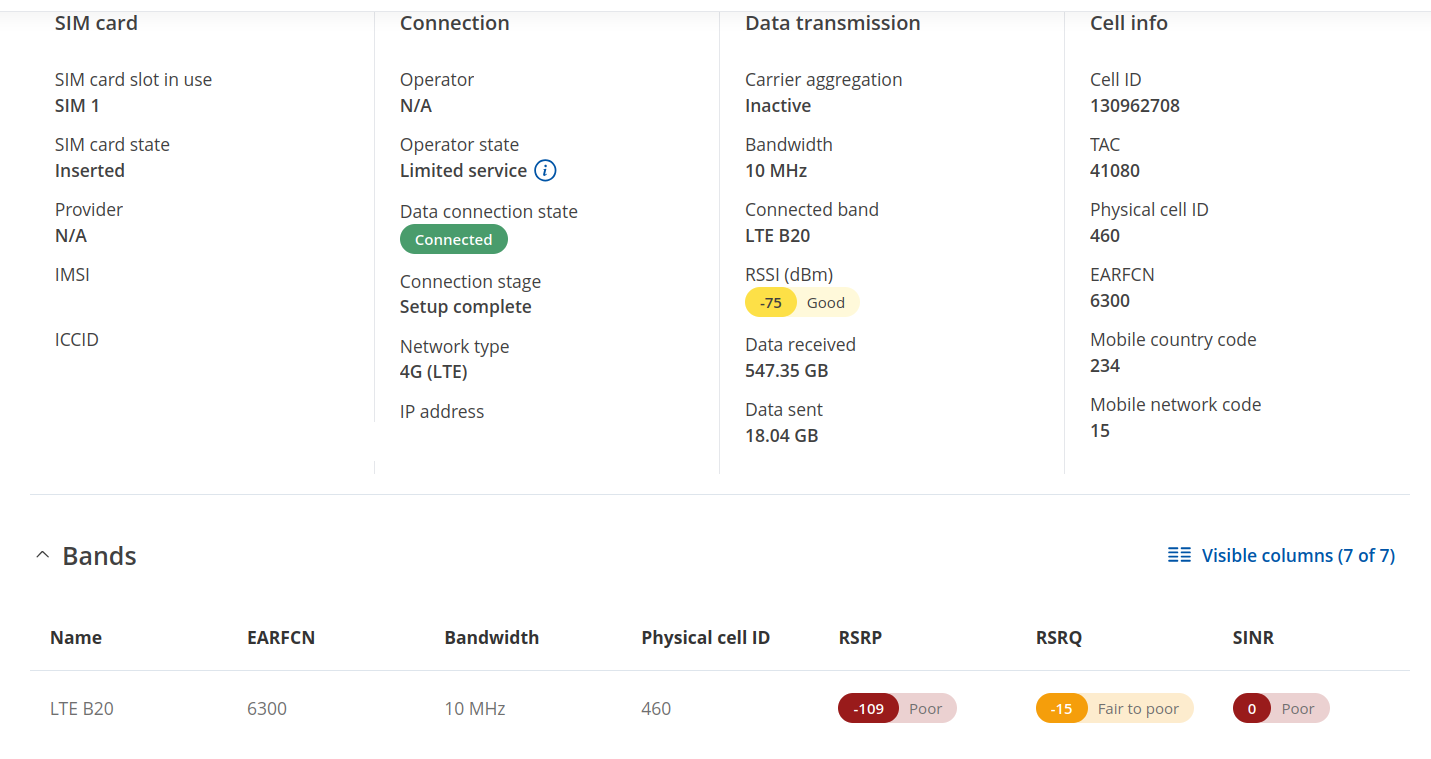

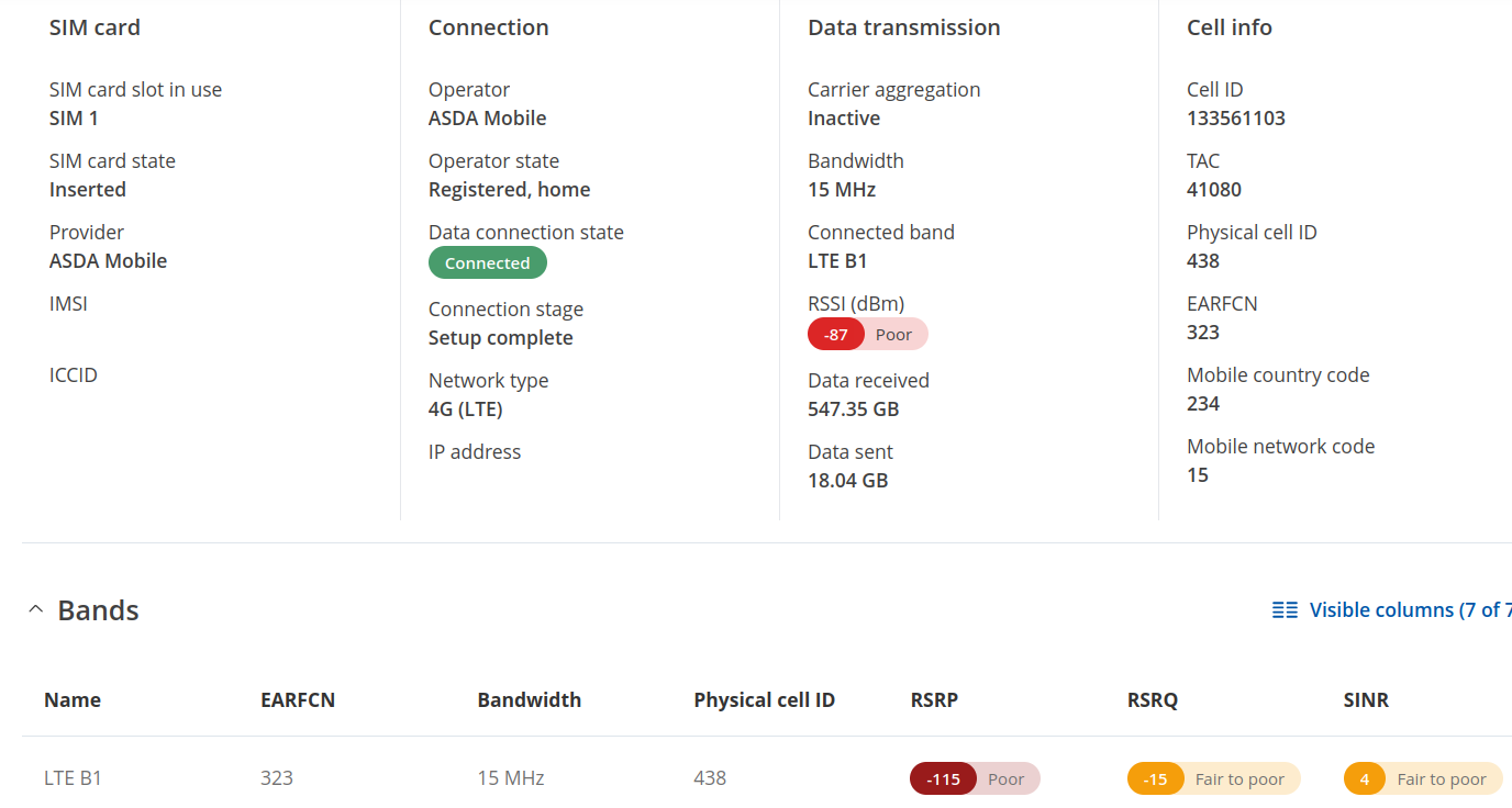

I understand this but sometimes the router only tries to connect on B20 showing the Operator as N/A, see screen shot 1, with NO internet connection. I have to manually select band B1 to obtain an internet connect as per screen shot 2. This is not logical, if a connection is N/A then surely the router should try the alternative band and obtain an internet connection.

I use the router in a van with an external antenna and travel extensively in the UK. In some locations I have to obtain an internet connection by choosing a different band manually which is illogical.
In other areas, even though signal strength in excellent on both B20 and B1, I have to manually change the band to B1 to obtain quicker internet speeds.

For example, where I am at the moment the router tries to connect to B20 but fails and that’s it no connection. I therefore have to select B1 manually to obtain a 15Mb connection.
Yesterday, in a different location with excellent reception, the router connected to B20 to give a 20Mb connection. Manually swapping to B1, also with excellent reception, gave me a 75Mb connection.

Thanks for the update. I am not in the specific area where I noticed the issue. However, I can see from my present location that the mobile channel is switching between B1, B8 and B20 therefore this issue may have been resolved.
