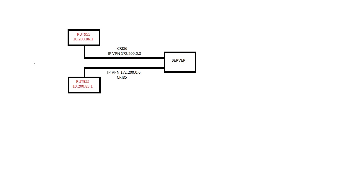

Would it be possible for you to share the network topology, including IP addresses, to illustrate how everything is interconnected? Additionally, please provide your OpenVPN server and client configurations. Before sharing this information here, make sure to hide any sensitive data, like public IP addresses and passwords.

Can you try pinging the server from the RUT device when connected to the VPN? And can the server ping back to the RUT’s local network at the address 10.200.86.1?
Could you please clarify if you are really using the 10.100.45.1 IP address in this scenario? Maybe you want to translate this IP via NAT? Or is the issue about getting the client’s local network to talk to the server?
Could you also show us the current routing tables on both the server and the client?
