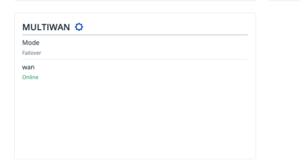

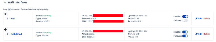

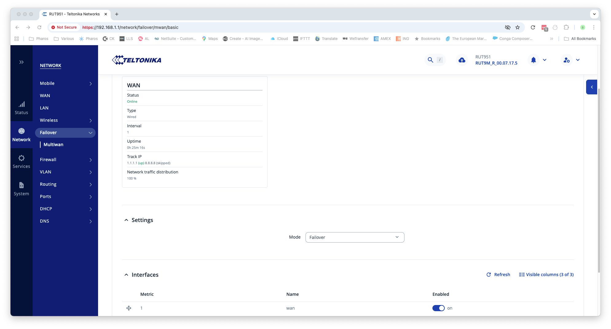

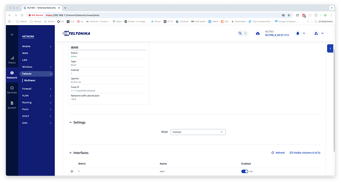

Under Network:Failover:Multiwan:General I only see the WAN port, this deviates from the help, and I can’t find a way to add the mob1s3a1 here.
Not sure if relevant, but on Status:Overview Multiwan indicates 'mode:Failover’..
whereas i would expect to be in normal mode, as the WAN port is connected and online.

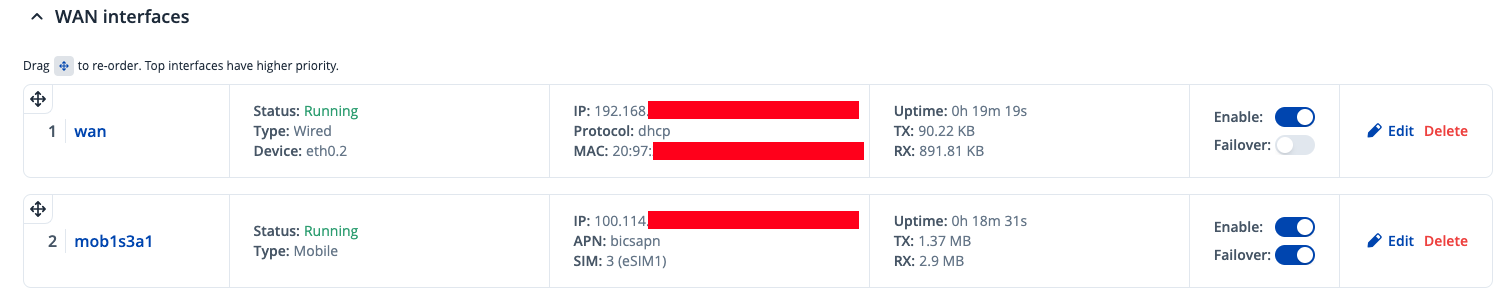

As seen from your attached screenshot, the WAN interface’s failover feature is disabled, therefore, it is not showing up in the failover menu. You can enable it simply by pressing the toggle button. For more information, please refer to this wiki article.
