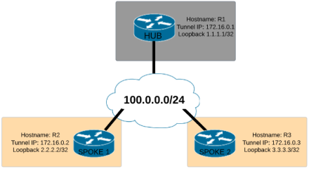

Hi, as far as I recall there must be an option enabled in FRR daemon which would allow multicast traffic alongside DMVPN configuration. However, I don’t think FRR is updated to an appropriate version where this option is supported yet. It might be possible to make things work by configuring a non-multicast OSPF solution (non-broadcast OSPF with specific neighbors), but this would incur additional configuration requirements on OSPF side.
For now, maybe you can try to use BGP instead of OSPF with route reflector setup? BGP should work over DMVPN as intended.
Route reflector setup suggestion would make BGP act sort of like OSPF, where you would have a hub router announcing routes to any RR clients which connect to it. Some more thoughts, ideas and configuration information could be derived from here:
