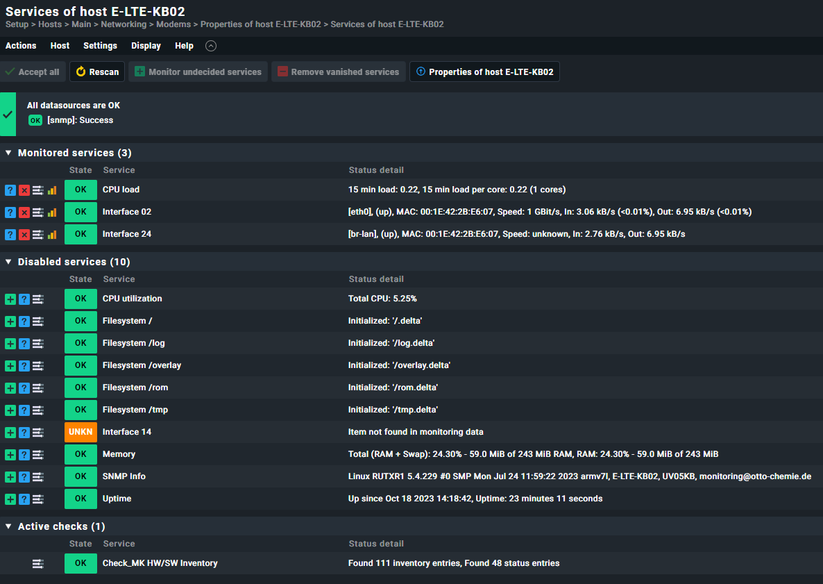

We have problems with the LTE-Interface. Sometimes we have no internet connection. So we want to monitor it (CheckMK). After upgrading to the newest firmware, the interface for the LTE connection (mob1s1a1) appearing after a rescan in our monitoring system. Some days later it disappeared and cannot be discovered again.
LAN or WLAN interfaces can be monitored. LTE interface is up and running. We use SNMPv3 for monitoring and rebooted the device several times. We also upgraded the internal modem to version EG06ELAR04A20M4G (newest).
Any suggestions how to fix it and get proper monitoring of our LTE connection?

I lost the OIDs I used in CheckMk due to a new service discovery. From the service discovery I haven’t got a new LTE-Interface (with different index), instead I have no LTE-Interface at all which is my problem.
From snmpwalk (SNMPv3) I got 1640 OIDs.

I did a reset of the device and reconfigured network and SNMP, but same behavior.
The interface for LTE is not recognized any more.
An interface 14 is discoverd, but no data can be found.
The LTE interface is up and running.
