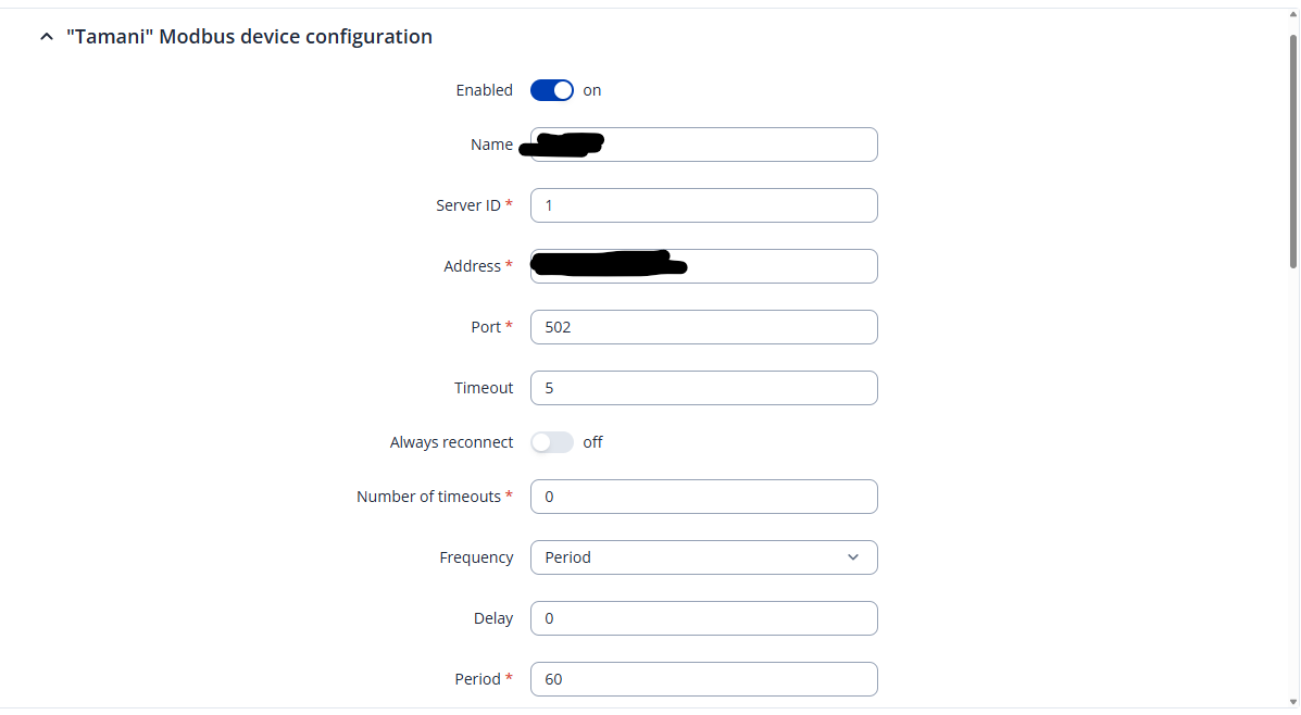

Could you please share screenshots of your exact Modbus TCP Client configuration on the RUT241?
When configuring the register on Teltonika devices, do not use the full prefix (e.g., 40562). Instead, just enter the value 562 . Selecting Function Code 3 (Read Holding Registers) automatically tells the router to look in the 40001-49999 range.
Additionally, please note that RutOS uses Register Numbers (starting from 1), whereas many other devices use Register Addresses (starting from 0). Thus, if that 562 is a register address, then on Teltonika, you will need to specify the number 563.

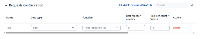

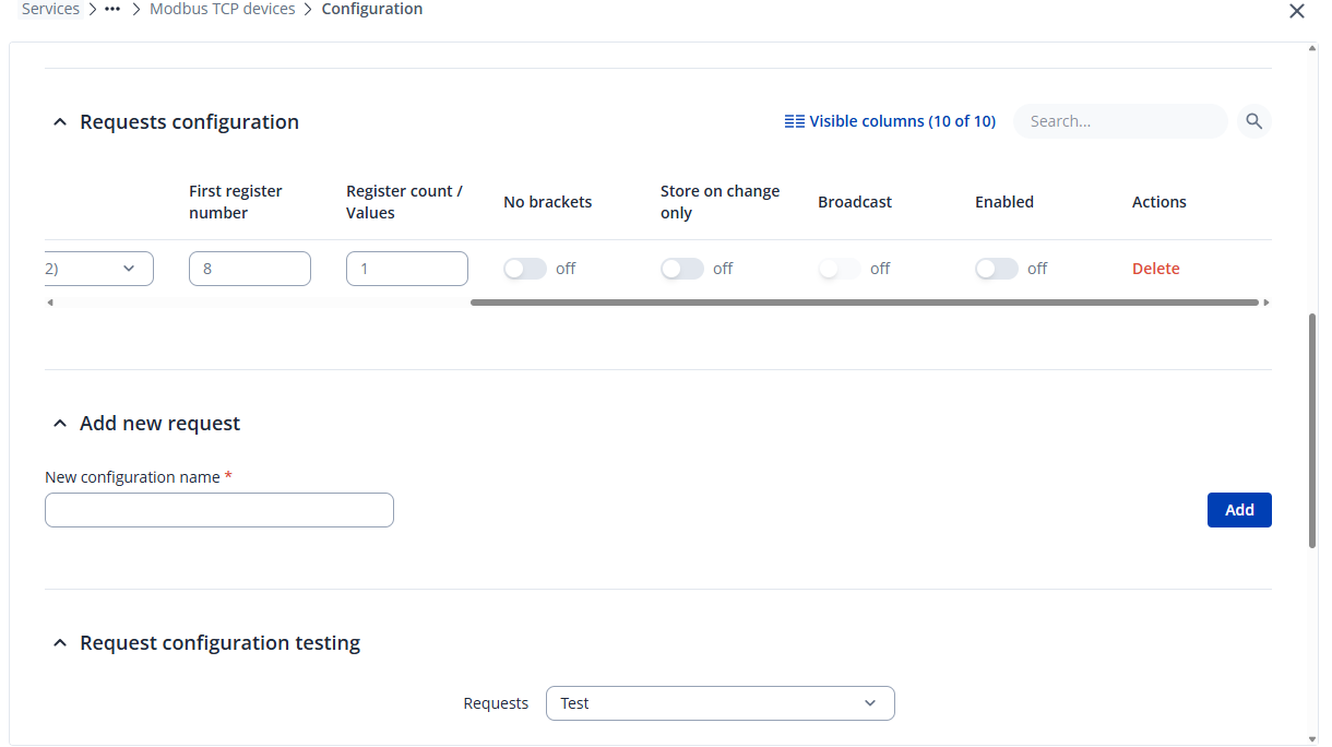

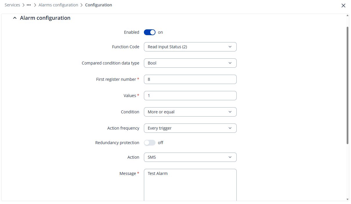

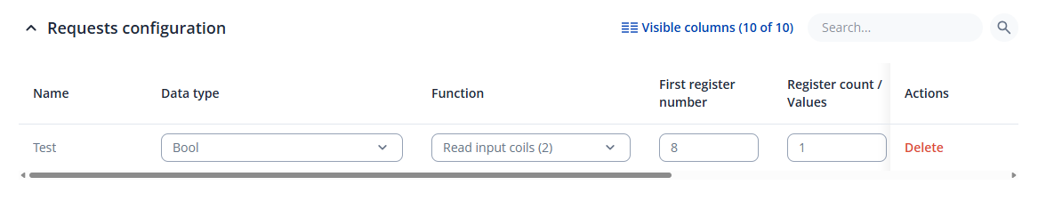

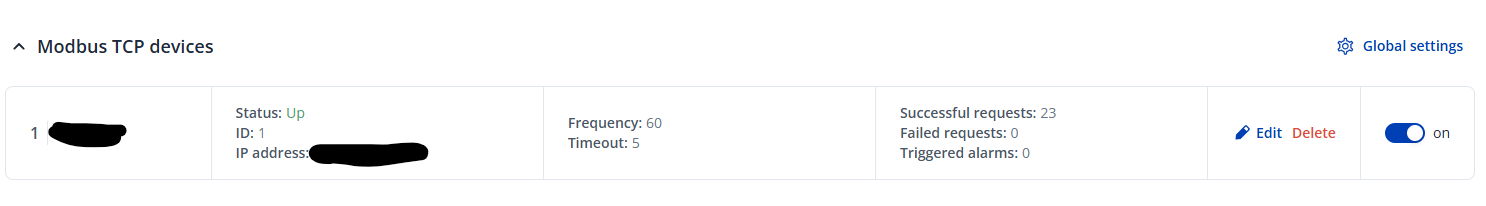

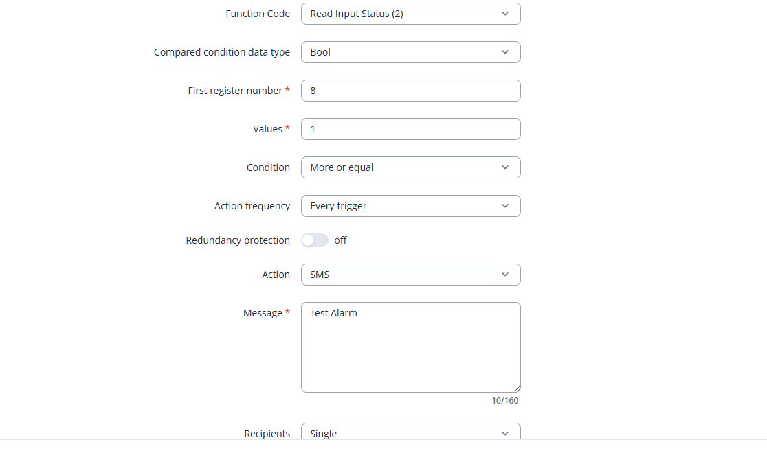

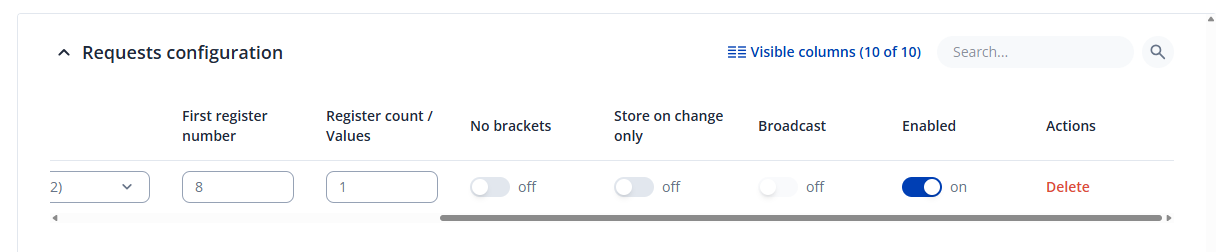

Thank you again for the helpful feedback earlier. I was able to get the system to begin registering successful Modbus requests; however, I’m still unable to trigger alarms. I’ve attached my current configuration below.
From what I can confirm on my end, the alarm condition is active, the Boolean value is sending a “1,” and my personal phone number is correctly listed as the SMS recipient. Despite that, no alarms are being triggered or sent.
Could you please help me verify the remaining configuration steps to ensure alarms are properly generated and delivered? I appreciate any guidance you can provide.
Thank you!

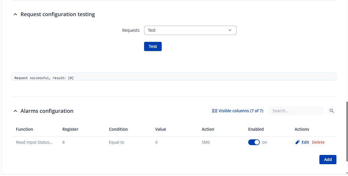

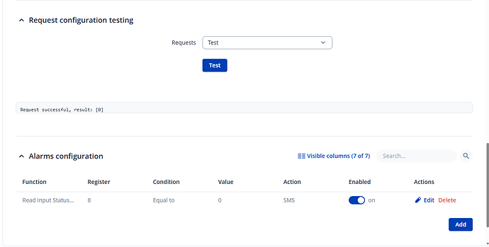

Could you please send a screenshot showing the value you receive when sending a test request?
Also, try changing the condition to Equal
Additionally, please disable the Test request and leave only the alarm configuration enabled to see if that makes a difference, since the request is not required for the alarms to function.

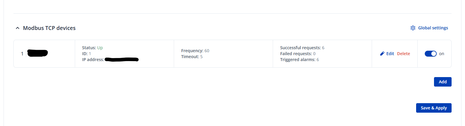

I completed the update and set the value to 0 to test whether the alarms would trigger. The interface shows that alarms are being triggered; however, I am still not receiving any SMS notifications. Do you know why the alarm may be triggering without sending any text messages to the phone number I entered? I did enable the requests configuration again because it didn’t seem to make a difference. The biggest difference was made by changing the value to 0 for the alarm. Please help me enable the texting when an alarm is triggered!
Per your request, I have attached the screenshots for reference. Thank you!

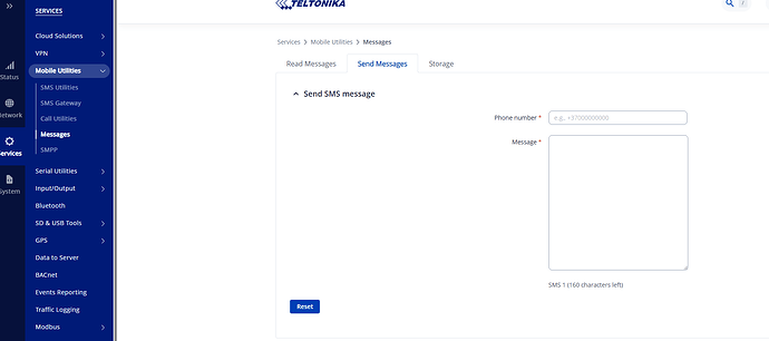

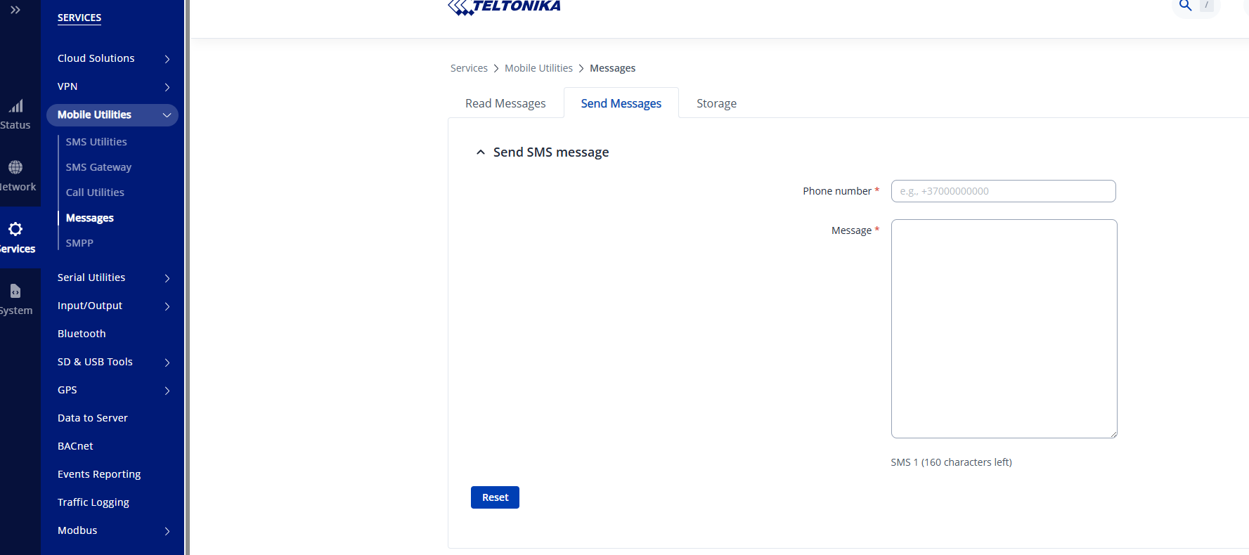

Could you please try sending SMS messages directly through the WebUI, without using the alarms, to confirm whether that works first? You can do this by navigating to Services → Mobile Utilities → Messages.
When entering the phone number, please include + or 00 before the number. If you are in the USA, you may need to add a single 0 before the number, if I remember correctly.
Thank you very much for the suggestions. I’ve tried all of the configurations you recommended, but unfortunately the issue is still occurring. If you have any additional ideas or troubleshooting steps I could try, I would greatly appreciate it. Thank you again for your help!
Can you clarify, are you able to send messages through the WebUI?
Yes I am able to do that!
Do you happen to have any other recommendations? I am not sure why it will not text my phone only from the alarms. I was able to send SMS messages to myself through WebUI. Thank you.
