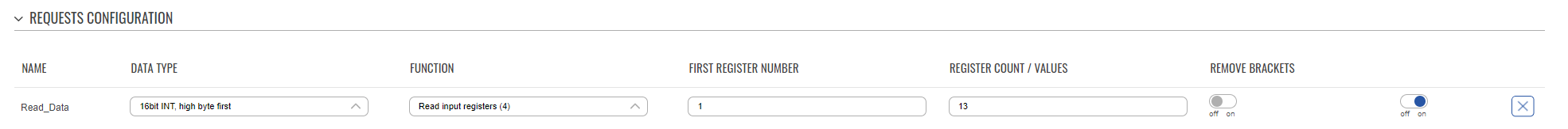

Yes something like that. The modbus request reads 13 registers and I send it the full array with the %a command in JSON package:
And my goal is to take only some registers and to send them separately in the JSON package, like described in the picture in my first message.
