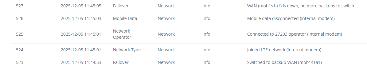

Hi Teltonika,
We use a RUTX09 and we normally have a primary wired WAN connection and a Mobile 4G connection for our internet access. We have upgraded from version 07.07.3 to 07.17.4 and I have noticed when the router is rebooted, and when the wired WAN is either disconnected or not configured upstream, this leave the only connection to be the Mobile 4G.
But when the router boots up, it will negotiate with the SIM provider, and after 2 seconds, it is disconnected, but yet show setup complete.
Logs below.
I am using Multi-WAN. When the wired WAN is configured correctly and multiwan policies pass, there is no issues. But this is observed when the only interface that can be used is 4G.
