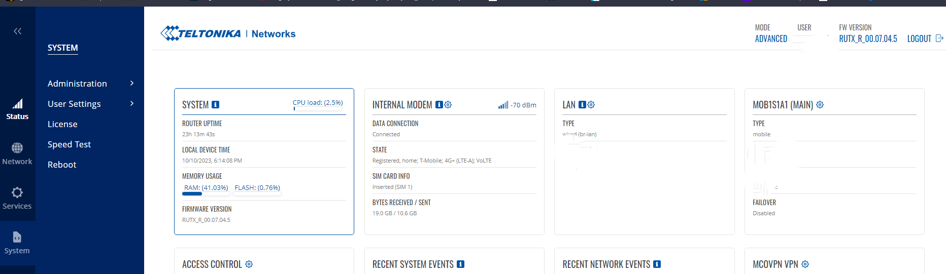

Uploaded screenshot.
Unfortunately, these settings should be visible in the WebUI when logged in as admin. You could check if the admin is user is actually assigned to ‘root’ group in System → User settings → System Users. However, this may not be the issue. It is likely that you would need to reset the device to defaults or perform the bootloader procedure as described here.
