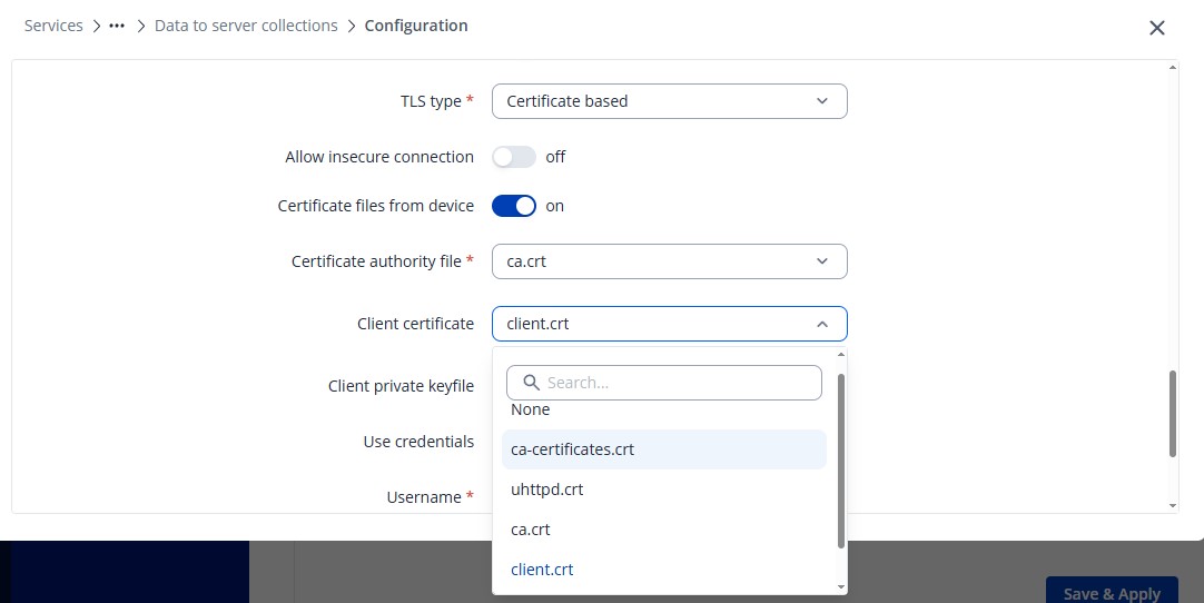

These work OK in the Data to Server module, when I select “Certificate files from device”. The files are shown in the drop-down lists and can be selected and work OK.

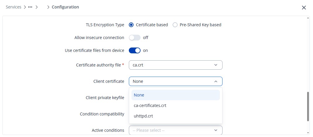

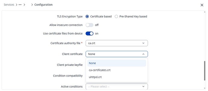

However, when I try and use these files in the Event Juggler, the client certificate is not shown in the drop-down list. If I load the certificates directly using the “browse” option, then everything works OK.
Why does the drop-down list in the Event Juggler not show the client certificate, while it is shown in the drop-down list in the Data to Server module?

Attached are the screenshots of the drop-down lists for the client certificate in the Data to Server service and for the Event Juggler service. As you can see the drop-down list in the Data to Server service includes the client.crt file which works OK, whereas in the Event Juggler service the client.crt file is missing.
