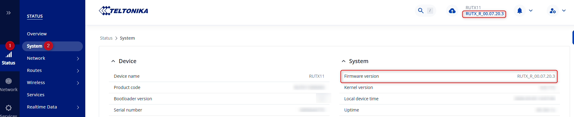

This shows modem version of the device, could you please log into the TRB device’s WebUI and navigate to Status->System and provide me with a firmware version of the device?
You should see a similar view as shown in the sceenshot:
I look forward to your reply.
this should be the FW version: TRB1_R_00.07.06.4
