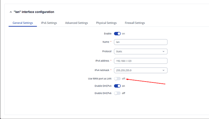

I’m trying to configure the router RUTC50 but have 2 sources of internet.
Uses the one which has internet to get redundancy.
One is connected to WAN port and the other should be connected to lan poert (LAN4 ex)
When I tried to follow this instructions:
I can only have on internet source, or is WAN or is LAN4, only if I enable/disable the “LAN as WAN” in the LAN>lan>GeneralSettings.
I dont achieve to have them both “seitching” automatically.
It seems possible, but I don’t know how to do it.
Can you help me trying to configure the router to achive these behaviour?

Just read on this article, not LAN4 particulary, but I assume this could be expander to other network. But no, i did not achieve to put LAN4 as WAN, at the same time the WAN is also functioning.
