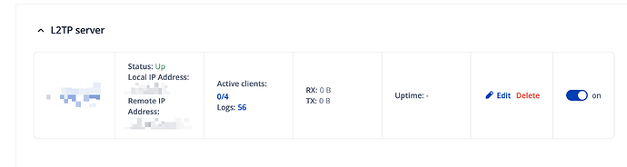

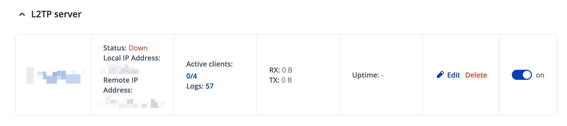

This is without any IPsec config

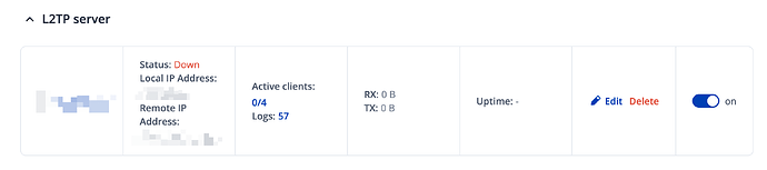

And this is how it looks with an IPsec configured
Logs showing this
1471 Sun Nov 9 22:31:20 2025 daemon.info xl2tpd[28561]: Listening on IP address 0.0.0.0, port 1701
1478 Sun Nov 9 22:47:14 2025 daemon.crit xl2tpd[28561]: death_handler: Fatal signal 15 received

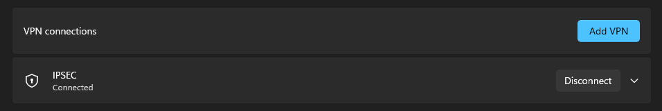

This is the log from when i connect with my windows PC and IPSec is up (this says 1/1 connected bit L2TP is down still)
1679 Sun Nov 9 22:52:29 2025 daemon.info ipsec: 14[IKE] <l2tp_srv|12> CHILD_SA l2tp_srv_c{1} established with SPIs c247b139_i edd80150_o and TS xxx.xxx.xxx.xxx/32[udp/l2f] === xxx.xxx.xxx.xxx/32[udp/l2f]

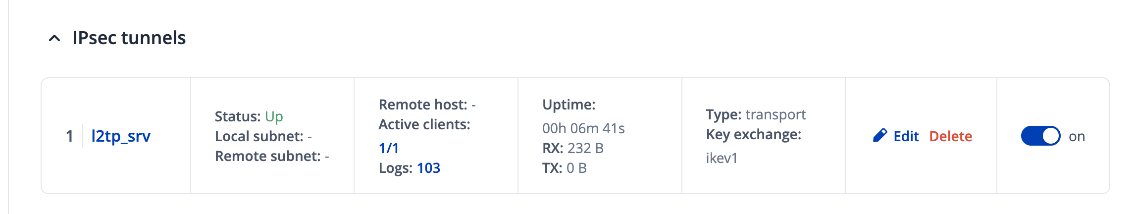

For clarity this is the IPSec, when i try to connect

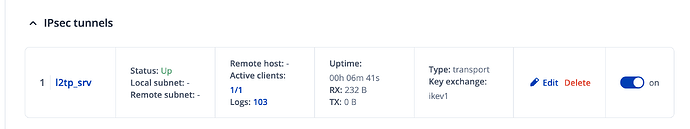

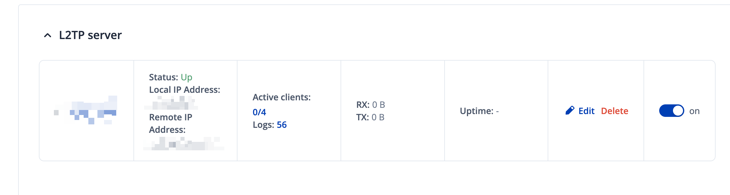

I then went ahead and upgraded the firmware to the current latest firmware, which is 7.19 - instantly, both of the tunnel statuses were “Up” and my PC successfully connected to the tunnel:

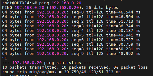

Pings didn’t go through at first - but I disabled my firewall on my PC completely and they started going through instantly:
If yours don’t go through, you may have to make some adjustments to the firewall settings of your network/machine.

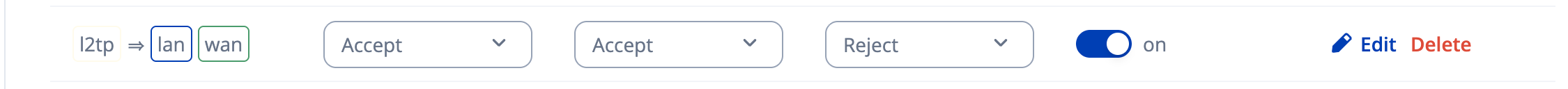

Looking at the rules, it looks like it has automatically created a zone called “l2tp” and that has accept towards the “lan” and “wan” zone
I also seem to not be able to reach the internet with the VPN enabled and running, that would probably be the same issue right?
