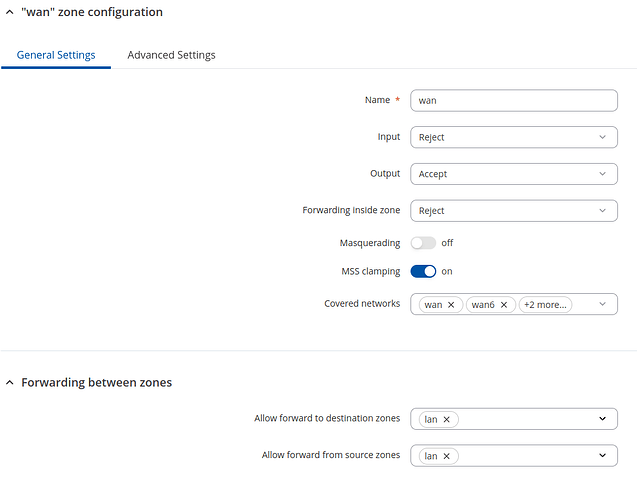

Is your mobile network able to route to your LAN IP subnet? If yes then you can disable NAT(masquerade) and allow forwarding from WAN zone to LAN. E.g.:
