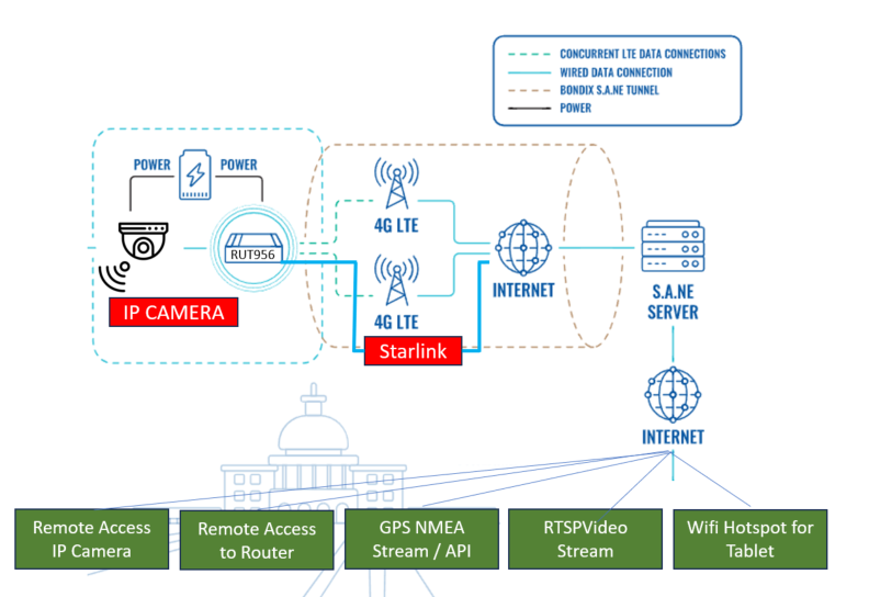

I am planning to build a light weight IRL Streaming Setup, to stream from a driving car (see picture above). Since I am planning to stream from different cars (partially oldtimers without USB plugs), ideally the setup runs from a powerbank, so that it is fully flexible to change quickly from one to another car.
I plan to use a Pan-Tilt-Zoom IP Camera that streams via RTSP protocol.
Like this, another person can remotely control the camera and manage the youtube stream, while I am driving.
In addition, I would like to bond 3 different connections (2x Sim Card, 1 x Starlink) for maximum streaming quality / stability.
After a lot of research, I found that the RUT956 router offers the perfect basis for this setup, because:
  • I can directly connect the IP PTZ camera via LAN port
  • I can connect 2x4G sim cards from different providers
  • I can connect Starlink via WAN
  • I can bond all 3 connections via SANE
  • The router and all connections can be controlled remotely
  • In addition, the RUT956 has embedded GPS, so I could create an NMEA feed (esp. Speed, Lat/Lon, Altitude, Heading)
In theory, the setup should work.
However, I have some questions and hope that you are able to help me out:
1. Sim Card with shared public IP addresses:
I think, most mobile providers only offer shared public IP addresses for normal sim cards (non B2B-contract) - not sure how it is with starlink though.
Question: “Is it possible to remotely access the IP cameras RTSP stream & WebUI via browser while using S.A.NE and on shared IP addresses from the mobile provider?”
By default the IP camera will stream to something like “rtsp://192.168.X.X”. However, this is the local address. In order to access it remotely, I need a DDNS setup, which, if I am not mistaken, only works with a public IP-address, right?
Anybody has found a work around for this?
2. Remotely Access the router:
Is it possible to remotely access the RUT956 router via DDNS while using S.A.NE with 2 shared IP sim cards?
3. Access altitude data from the RUT956 GPS module:
When I check the GPS data in the admin WebUI of Teltonika, I can only find LAT / LON / Speed.
I cannot find altitude. Anybody knows how to access the altitude data and how to access the live data via a feed / stream / API to be able to create a stream overlay?
Thanks a lot for your support.
Best regards!
Thanks for contacting Teltonika Networks’ technical support team.
Before I start answering your questions, I would like to recommend a different device. In your specific situation, RUTX12 would be a better router.
You are correct, RUT956 has 2 SIM slots, but it has only 1 LTE CAT4 modem. Meaning, that RUT956 can use only 1 SIM card at a time. The second one will work as a backup and bonding would only potentially work with 1 mobile interface, wired WAN, and Wi-FI at the same time. In addition, RUT956 has only 100 Mbps ports and supports 2.4GHz Wi-Fi.
On the other hand, RUTX12 has 2 LTE CAT6 modems and 2 SIM cards. RUTX12 can use those 2 SIM cards at the same time. With this device, bonding will work with 2 mobile interfaces, wired WAN, and Wi-FI simultaneously. You will get even better streaming quality/stability. In addition, RUTX12 has gigabit ports and supports 2.4GHz and 5GHz Wi-Fi.
You mentioned that this setup will run on a powerbank inside a car. Teltonika Networks also provides an automotive power supply adapter: AUTOMOTIVE POWER SUPPLY.
If are concerned about power usage, then you could choose RUTX11. Keep in mind that RUTX11 has only 1 CAT6 modem and you will be able to use only 1 SIM card at a time. RUTX11 Is a little bit more power-friendly, even though it offers similar performance when comparing RUTX11 and RUTX12 with 1 SIM card active.
For more information regarding RUTX11 and RUTX12 power usage view the pages below.
RUTX11 power usage tests: RUTX11 Power Consumption - Teltonika Networks Wiki
RUTX12 power usage tests: RUTX12 Power Consumption - Teltonika Networks Wiki

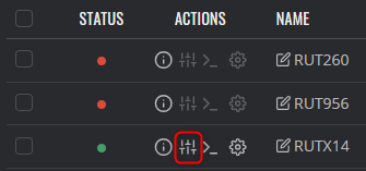

To remotely connect to your router’s WebUI you can simply generate WebUI access link and connect to the device.
Go to Devices and select the Device WebUI button.
2023-10-19_11h24_25
In the window, press Connect. This will generate a WebUI access link for 30 minutes. If you want a link that would last longer then, change the Duration until settings according to your needs. Then press Generate.
