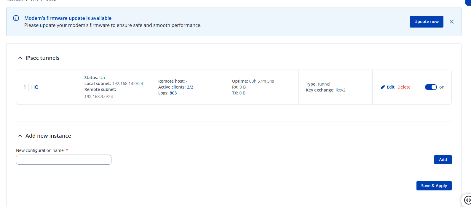

Hi, I configured according to the configuration example. The tunnel is up, but I could not ping to both sides. Please let me know any further details needed

  • What exactly are you trying to ping? Is it a router that is on the other side of the tunnel or is it a device that in this router’s LAN (behind the router)
  • Which way the ping does not come through?
  • Does both ends of the tunnel have a public IP address?
  • Could you please provide us with a topology or scheme of your network? Please exclude any personal data like public IP addresses.
