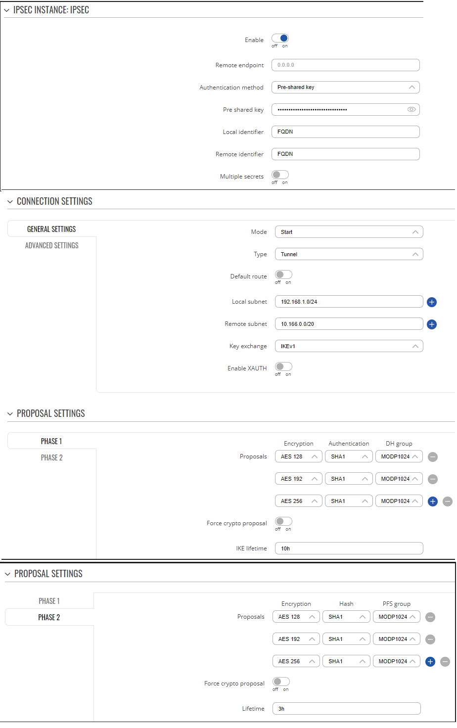

And on RUT955 side:
daemon.info ipsec: 08[IKE] no peer config found
daemon.info ipsec: 08[ENC] generating INFORMATIONAL_V1 request 806038484 [ HASH N(AUTH_FAILED) ]
RUT955 configuration:
The issue seems to an issue in authentication phase. I noticed your local and remote identifiers are specified as FQDN. Are you sure this is correct?
FQDN (fully qualified domain name) usually looks like somehost.example.com. An alternative could be to use to use an IP address. The most important key is that both sides must match on both sides. Let’s say you are using somehost.example.com as a local identifier. Then somehost.example.com should also be used as remote identifier in GCP.
Alternatively, %any can be used to accept any identifier. This can be used in both - remote and local identifier fields.
