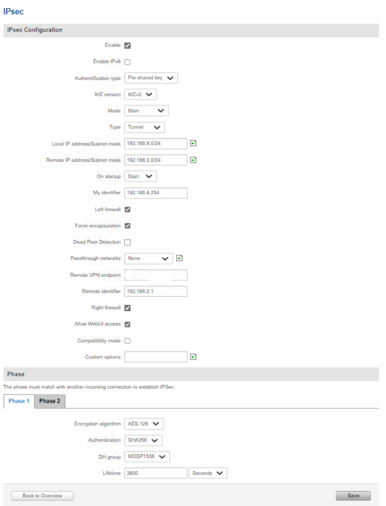

I have successfully established an IPSec site-to-site connection between a SOPHOS XGS firewall and a RUT240 from Teltonika.
A ping from the Teltonika router to the SOPHOS firewall works. A ping to an end device behind the SOPHOS firewall also works.
A ping from the SOPHOS directly to the Teltonika router works. However, I cannot reach any end device behind the Teltonika router.
If I do a route tracing on the SOPHOS, it looks as if the route only goes as far as the Teltonika router and then either no further.
Where is the error?
