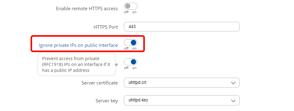

I’d also recommend trying to disable the following option in System → Administration → Access Control:
Additionally, verify that the rebind protection was disabled in Network → DNS menu:
