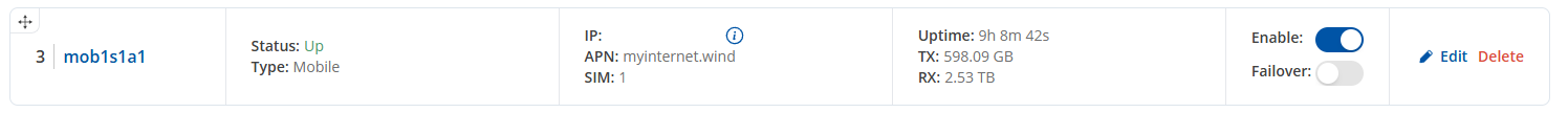

I am using a RUTX50 router (SN: ****, Hardware Revision: 0202), currently operating with firmware version RUTX_R_00.07.13.4.
Starting from firmware versions released after that (including RUTX_R_00.07.14.1 and later), the router exhibits a recurring issue: every 8 – 12 minutes, SIM 1 is disconnected, the corresponding SIM LED turns off, while the 4G/5G and signal strength LEDs remain on. The issue affects all firmware releases tested since May 2025 (including RUTX_R_00.07.15.2) and is independent of the SIM card or slot used. The SIM card itself functions properly on other devices.

I’ve already done that — I manually set the APN after confirming the correct value with my mobile provider, but the issue still persists.

The issue has been resolved by upgrading the modem’s firmware version to the latest.
