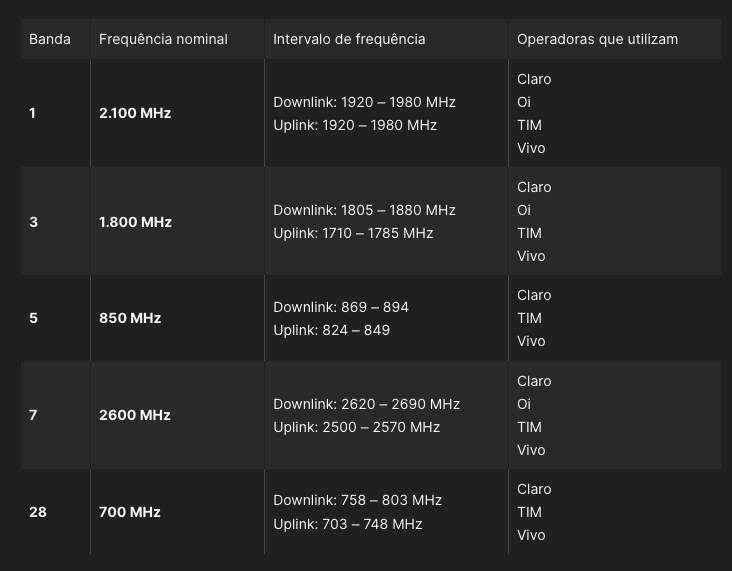

Here at Brazil… make sure the device will have the support to b1,b3,b5,b7 and b28.

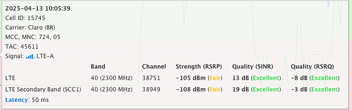

CLARO, sometimes use LTE B40.
