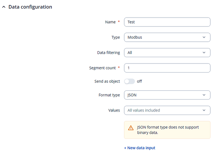

On Services → Data to Server add a new collection.
The Data configuration should look like shown in the picture.

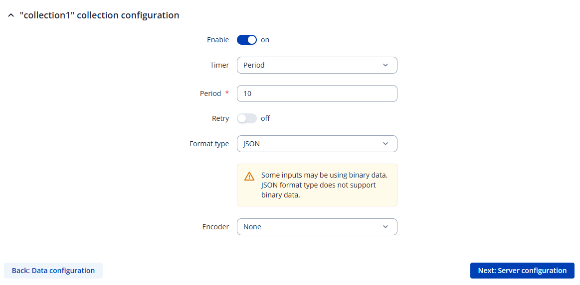

After that click Next and configure the collection

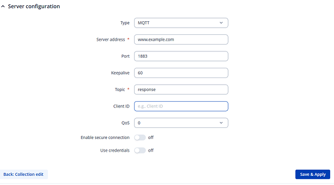

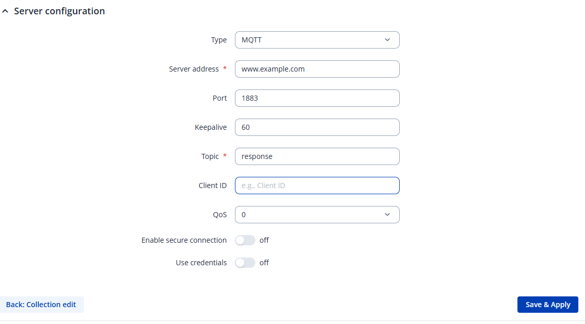

After that click Next again and configure your server settings after choosing MQTT.
Keep in mind that this is just a simple example, and the final configuration would depend on how you collect the data through the RS232 port and in what format you want to send it. Please send me more information about that, and I will be able to assist you further.
