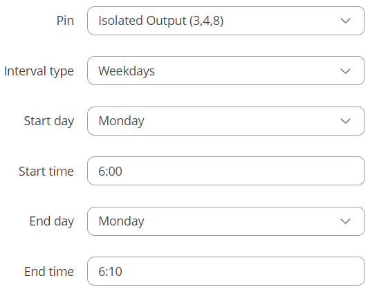

To replicate this configuration, disable first the SMS utilities for changing I/O (ioset). I/O scheduler and SMS utilities can’t be enabled at the same time.
Then, go to Services → Input/Output → Scheduler → Click on edit button → Enable the instance
This configuration will turn on Isolated Output for 10 minutes every day at 6 am. Make sure that your NTP server / Time Zone is synced in your area.
Let me know if this helps.
Hi Janmiguel,
I’v e follow your suggestion, but no effect, the ioman process is started but non effect on I/O (seems not working, i’ve try restart router after each change in scheduler but no result wathsoever)
Forgot to mention that the start and end day should be the day today (i.e. Wednesday) for the rule to apply immediately. In the configuration above, scheduler will start to trigger the output on Mondays.
In order to work with above instruction, in:
Services > Mobile Utilities > SMS Utilities
Must be turned OFF the “Change I/O state”, otherwise the scheduler don’t work.
