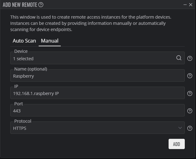

  • Select the manual section.
  • In Search Devices select RUT951. Add name, write Raspberry IP, set port 443, and select HTTPS protocol.
Since you asked for an HTTPS connection example, I set the port and protocol accordingly. If you want to access a different service change the port and protocol values accordingly.
If want to know how to connect to SSH, Telnet, HTTP(S), RDP/VNC, or SFTP services. View our wiki page: RMS Remote Access - Teltonika Networks Wiki.
Below is a configuration’s example to connect to the device’s HTTPS service:
After pressing add. Press the play button. RMS should show your HTTPS service UI.

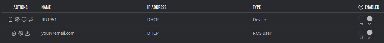

The VPN hub clients section should look similar to this:
After add the clients download the VPN configuration file. Press the download button near your RMS user. You will receive VPN configuration file.

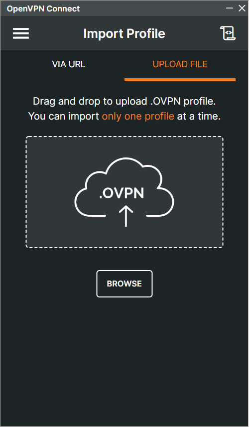

Now you will need to download OpenVPN connect for your computer. After downloading the program install it and launch it. In OpenVPN Connect select Upload file.
Press the Browse button and select the VPN configuration or simply drag the file that you have just downloaded. After importing the file press the orange Connect button.
Now your computer should be in the same VPN network with RUT951 and devices under it.
