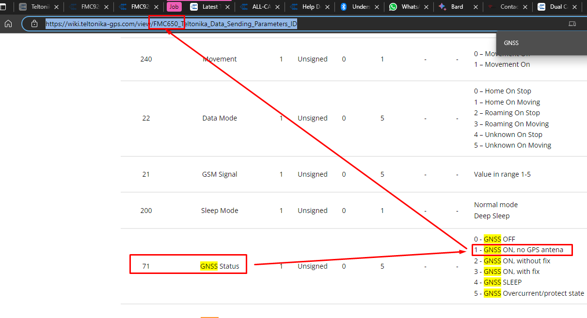

GNSS status for Antenna Tampering is available for the FMX650 devices.
If you check the Data Sending Parameter and look for the GNSS status ( AVLID71 )
The value pertaining to removing the GNSS antenna is
1- GNSS ON, no GPS antenna.
Reference: FMC650 Teltonika Data Sending Parameters ID - Wiki Knowledge Base | Teltonika GPS (teltonika-gps.com)
