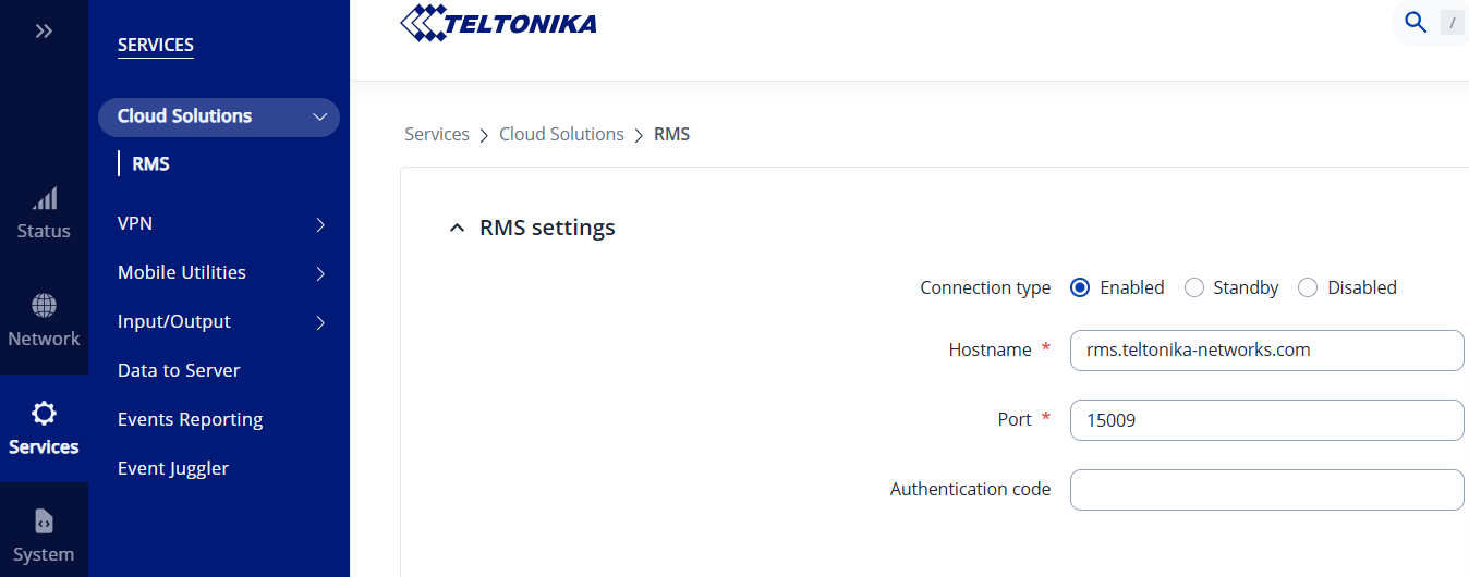

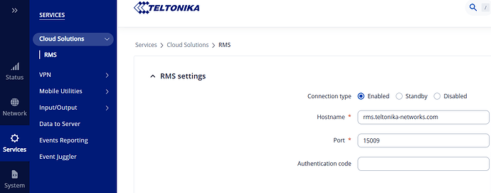

I would like to clarify whether you are using our RMS system.
If not, please disable the connection by navigating to Services → Cloud Solutions → RMS.
After disabling it, reboot the device and check whether the connections reappear.
thanks for your suggestion, but RMS is already turned off. You can see this kind of connections as soon as you open the package manager page. Perhaps it is trying to check for updates.

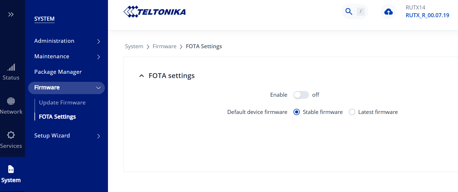

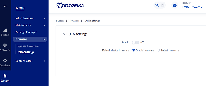

Please begin by disabling Firmware Over The Air (FOTA), which is responsible for the connections to some AWS addresses
After that, we can disable the package manager feeds.
