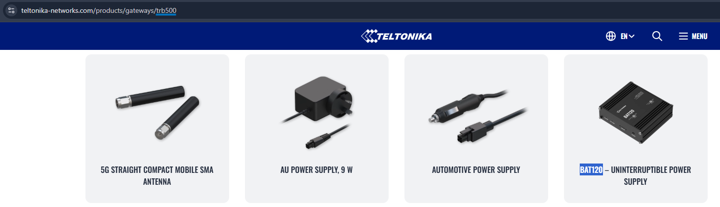

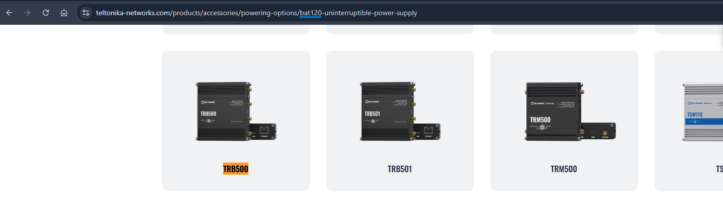

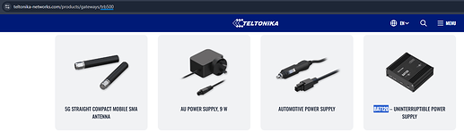

By the way, TRB500 is not listed as compatible with BAT120.
Compatible devices
RUT2xx, RUT95x, RUT3xx, RUTXxx, TRB14x, TRB2xx, TSW110, TCR100
Could you tell me on which page you found it? On both the TRB500 and BAT120 product pages, I can see them listed as compatible under the Compatible Products lists:
You linked to the product and the quote is from there.
This means that the information may be incomplete, contradictory etc
Thank you for mentioning this. Yes, the information in this particular section is outdated, and I’ve already inquired to have it updated once our product site launches on the updated platform. For now you should rely on “Compatible products” dropdown list.
