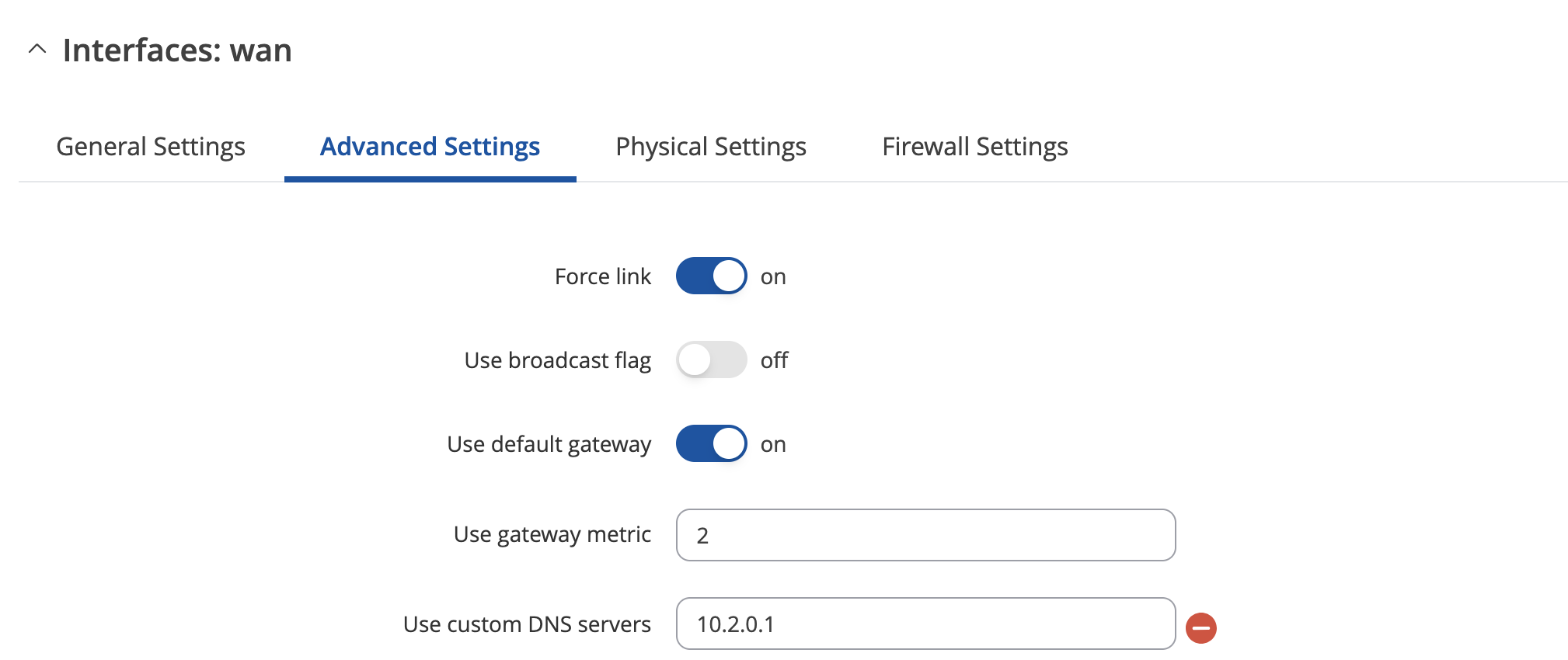

For the last 2 years im unable to make the configuration with wireguard client works on teltonika (I have rutx11) and im wondering if someone made it work.
if someone can give me a help, i appreciate
here it goes my configuration screenshot.:

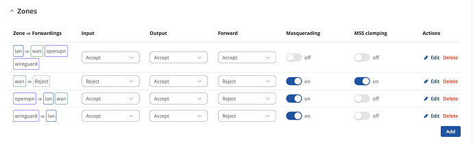

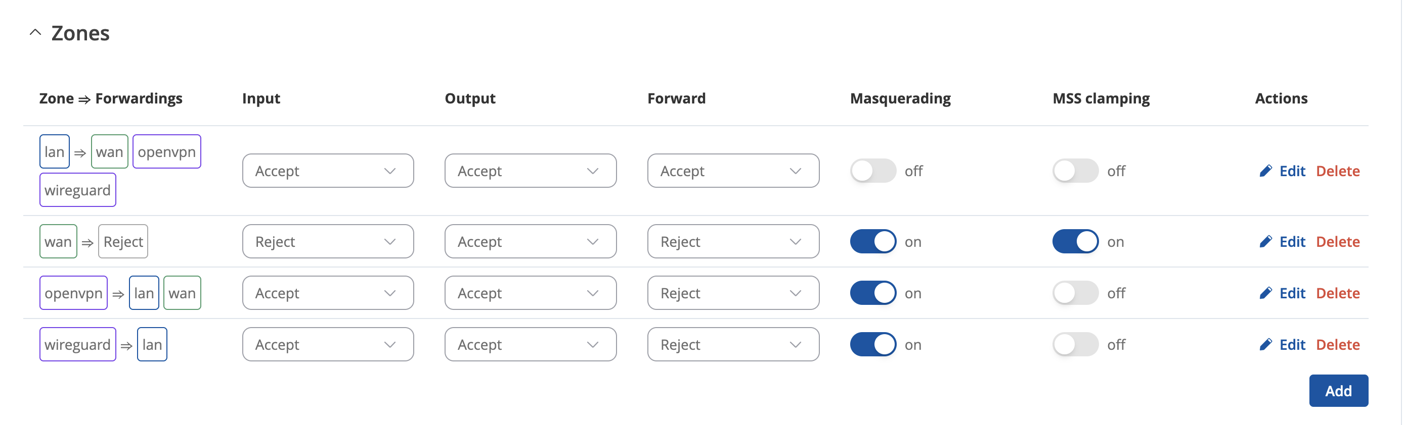

And of course make sure that there are no conflicts between the address ranges covered by openvpn and wireguard, or don’t use both at the same time.

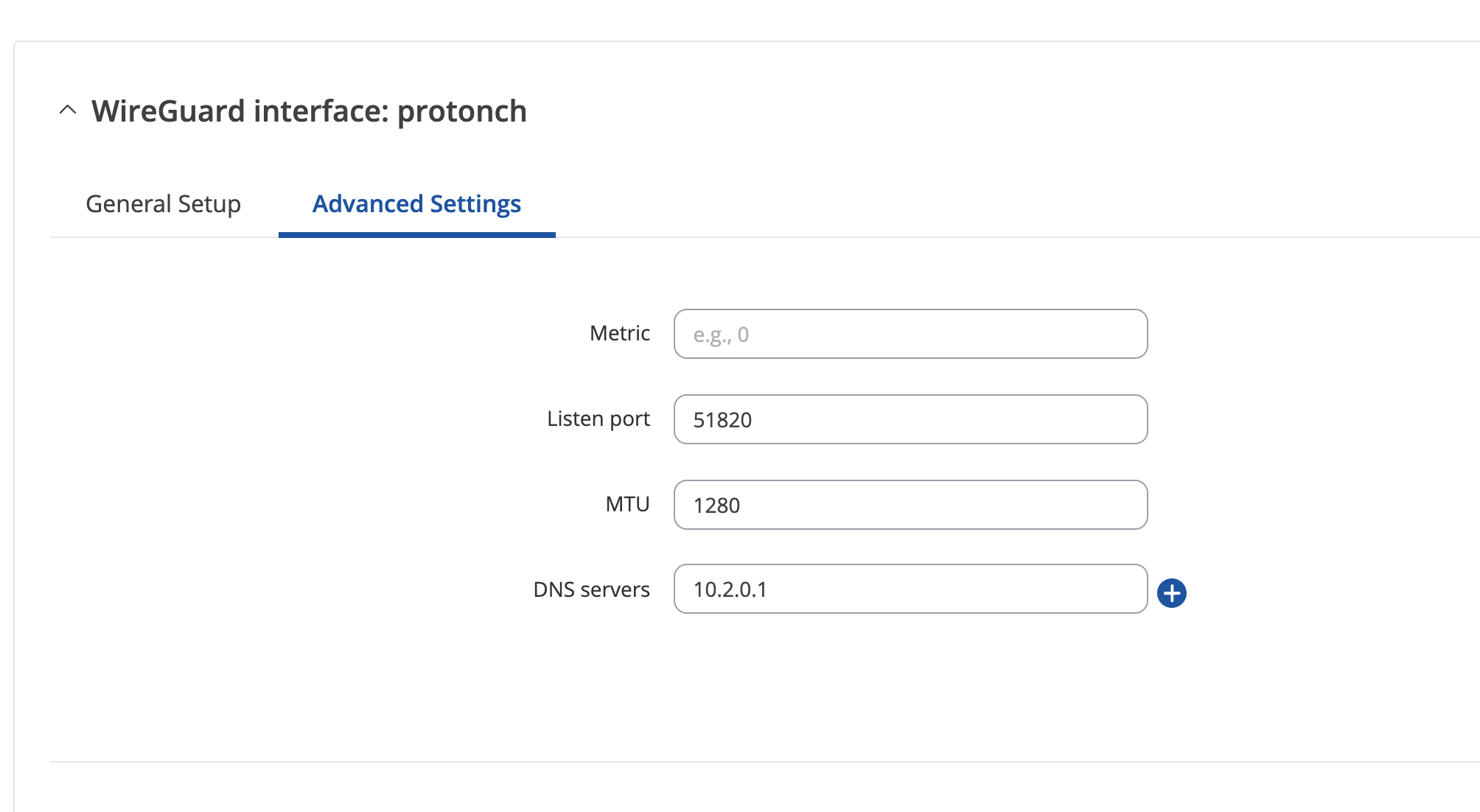

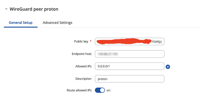

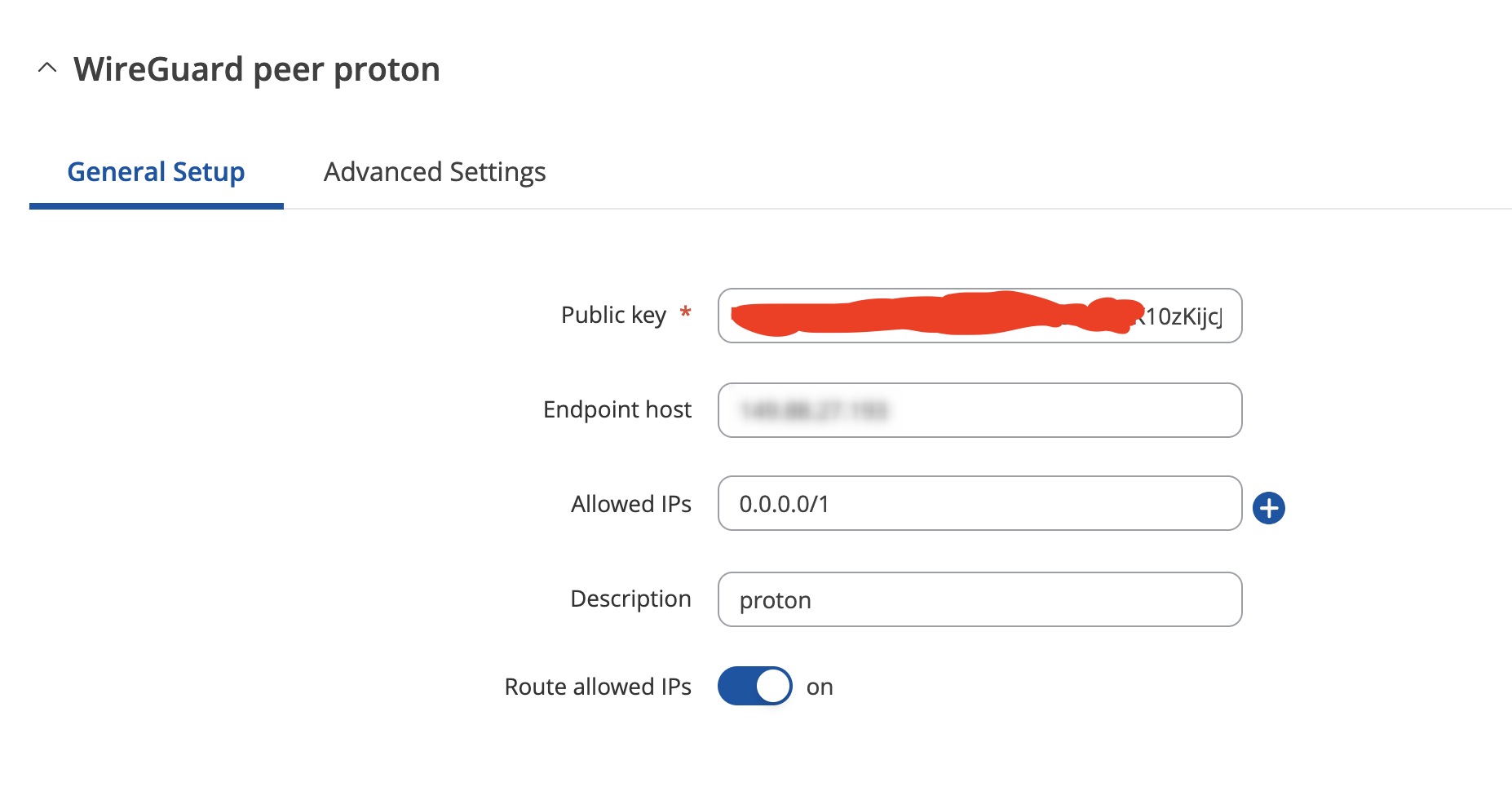

If the tunnel still fails please show the contents of protonch->General setup and peer proton->Advanced settings.

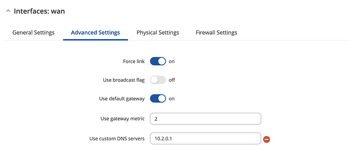

I would like to thank you for the super help, its working. i will upload the screenshots with the config that maybe will help others.
Once more: Thank you !
