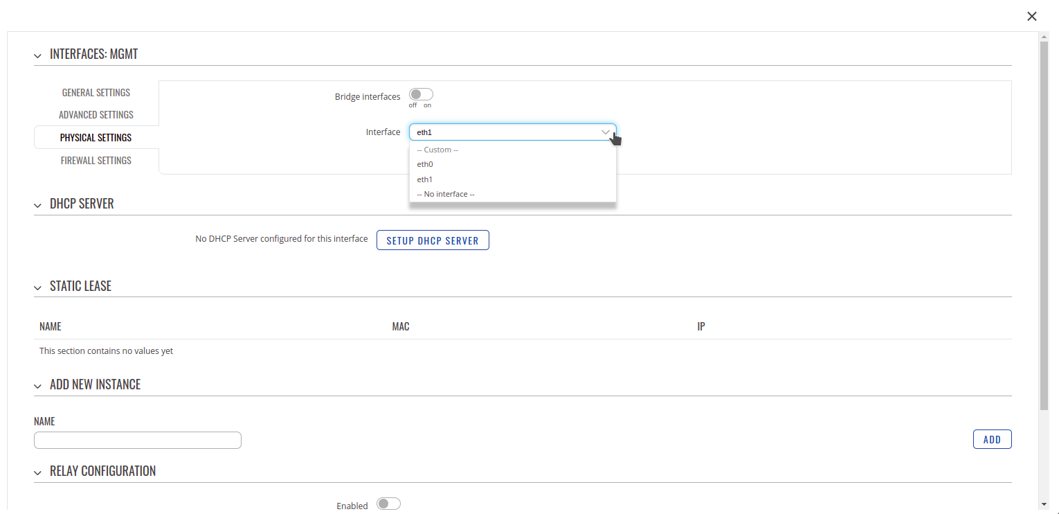

i have a RUTX12 and i need to assign lan 2, 3 and 4 each with their own fixed iP addresses or have them receive iPs from a DHCP server
Unfortunatly as seen i the screen shot i only have Eth 0 that is lan1 and eth1 is WAN.
Is it possible?
if yes what do i need to do?
ETH0 is a physical device used by all LAN ports. You can separate those using untagged VLANs. You can find VLAN configurations examples here. In case you are looking to manage access between those VLANS (ports), I suggest you take a look at our article here as well.
