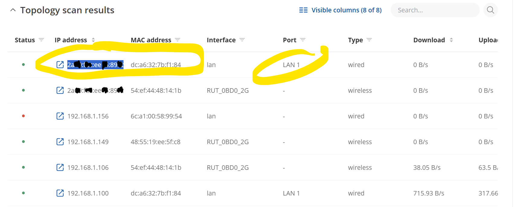

My Host on LAN1 connected to the RUTC50 is getting from DHCP, a private IPv4: 192.168.1.100 and a IPv6 coming from the delegated IPv6 Prefix: 2a..:f..:ee..:89..:dd52:536f:bd70:594d

Thanks Laura,
Ok you mean I need only a Firewall Rule WAN → LAN with IPv6-PD destination Address of the LAN1 Device?
With the rules beneath it worked, but how can I automatically update the IPv6 when the address has changed?
