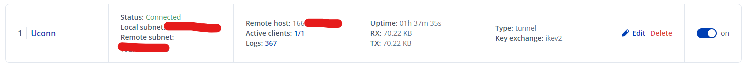

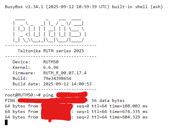

Hi, I am trying to set up an IPsec tunnel between a RUTM50 (Hub) and a RUTX11 (Spoke). I have configured the IPsec tunnel on both routers, and the status says connected. I can ping the private IP of the RUTX11 from the internal CTL window of the RUTM50 but not form my laptop’s Com Prompt window that is connected to the RUTM50 router. Can someone help?
The tunnel on the RUTM50
Pinging RUTX11 from RUTM50

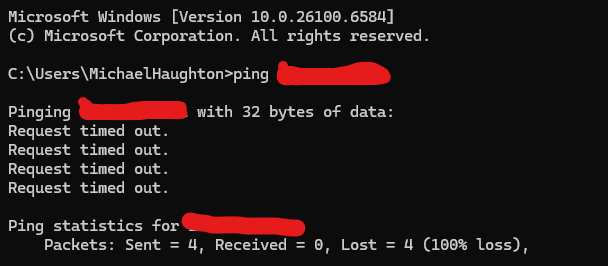

Pining RUTX11 from my Laptop’s Command Prompt window.

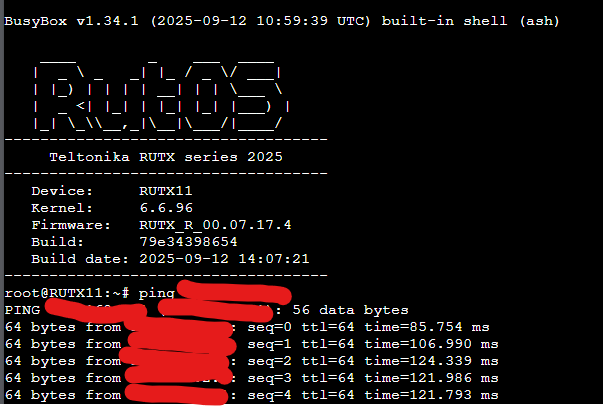

Pinging RUTM50 from RUTX11
I guess no one will be able to help you in any way if you blur/hide even the private IP addresses.
Maybe you just have your laptop connected to two routers simultaneously (e.g., office network over WiFi and RUTM50 over Ethernet cable)? That would explain everything. In such a case, simply disconnect your laptop from other devices during testing.

Thank you this was a part of the problem. I turned off the connection to the office Wi-Fi, and I was able to ping the router.
