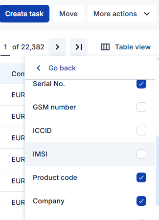

Dear @LeifHolm,
I hope you are doing well. Unfortunately, FOTA Web could only provide the ICCID or IMSI of the SIM card installed on the device and not the GSM Number.
You may activate it on the Table view, under the More Actions Tab.
I hope this helps.
Patrick S.

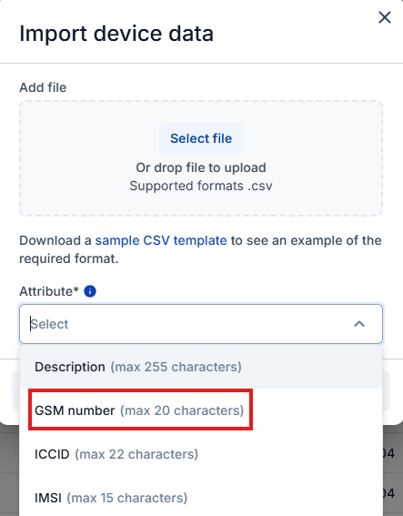

Hello @LeifHolm,
Thank you for your feedback. It is showing because there is an option to import the device’s GSM number through FOTA, but automatically, only the ICCID and IMSI information can be taken on FOTA Web.
Patrick
Tnaks
That’s just the information i neded :blush::blush:
But can’t i somehow type it in on just one number?
Hello @LeifHolm,
Yes, you can do the import on 1 device however, you need to still import it.
Patrick
