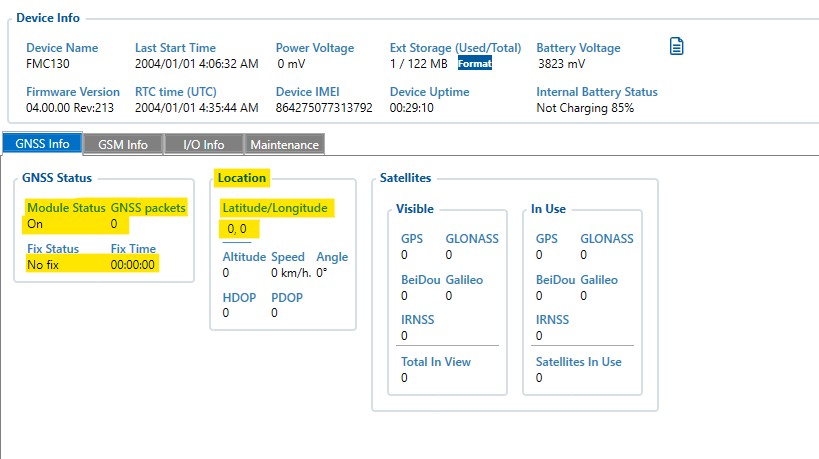

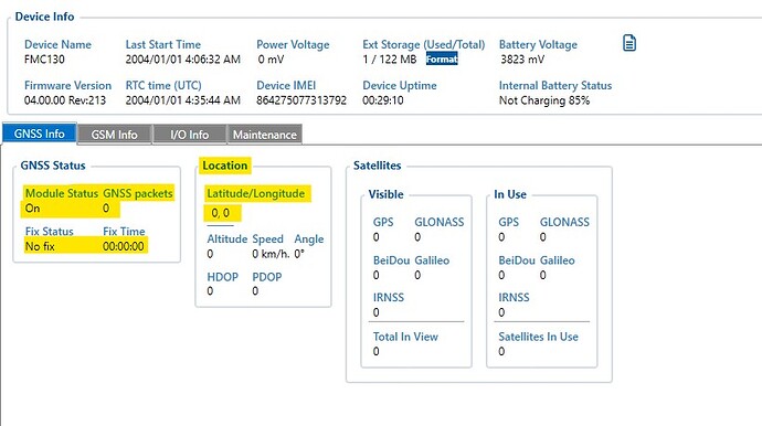

Dear sir Device FMC130 Firmware New ver4 04.00.00 Rev:213
Send SMS
to GPS Data not Available. No GPS signal.
When was the last time you know it was working correctly?
Don’t know if the device normally gets its date and time from a mobile connection, your browser or via the satellites but the date and time is way out. This could make a difference.
Have you checked that the GPS antenna is firmly connected and not damaged at all. Does it currently have a mobile connection?
Where is the device, is it in a vehicle, metal box? Is the GPS antenna outside that metal box?
my dear Davies in office not installed in cars and outside office not signal Satellite
GNSS Packets 3
Module Status ON
Fix Status ( No Fix )
Fix Time 00:00:00

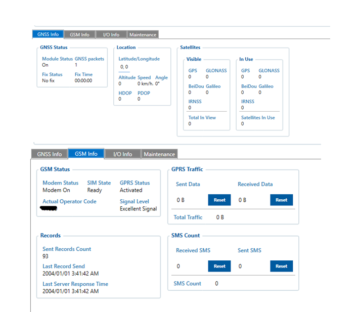

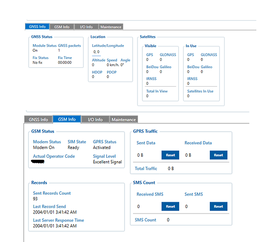

Hi Dear sir
now devise is out said office not any send data to servers
see this pic
hi pro thank you feedback me
pro now out office satellite not work now
can you see this pic
Are you also connecting an external power source, such as a 12V/24V adapter or battery? Sometimes the device may not show GPS satellites properly when it is not connected to stable external power.
Please try the following:
  • Connect the device with external power.
  • Place the device outside where it has a clear view of the sky.
  • Then check the GPS status again.
If it still does not work, then there may be some other issue with the device that would require further troubleshooting steps. In that case, I suggest contacting your Teltonika partner, sales manager, or seller for further assistance.
