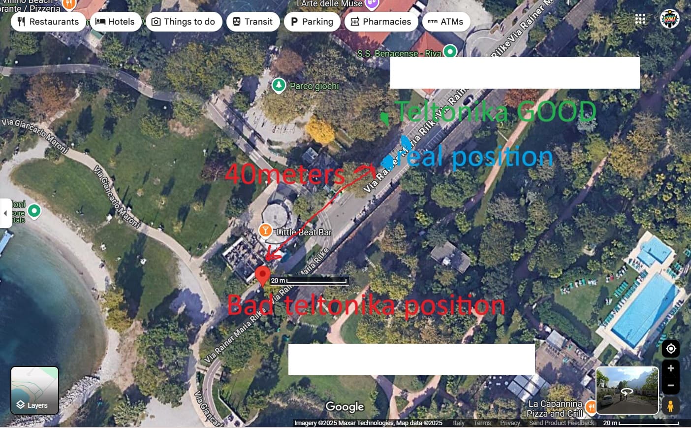

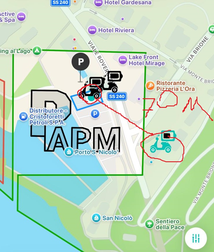

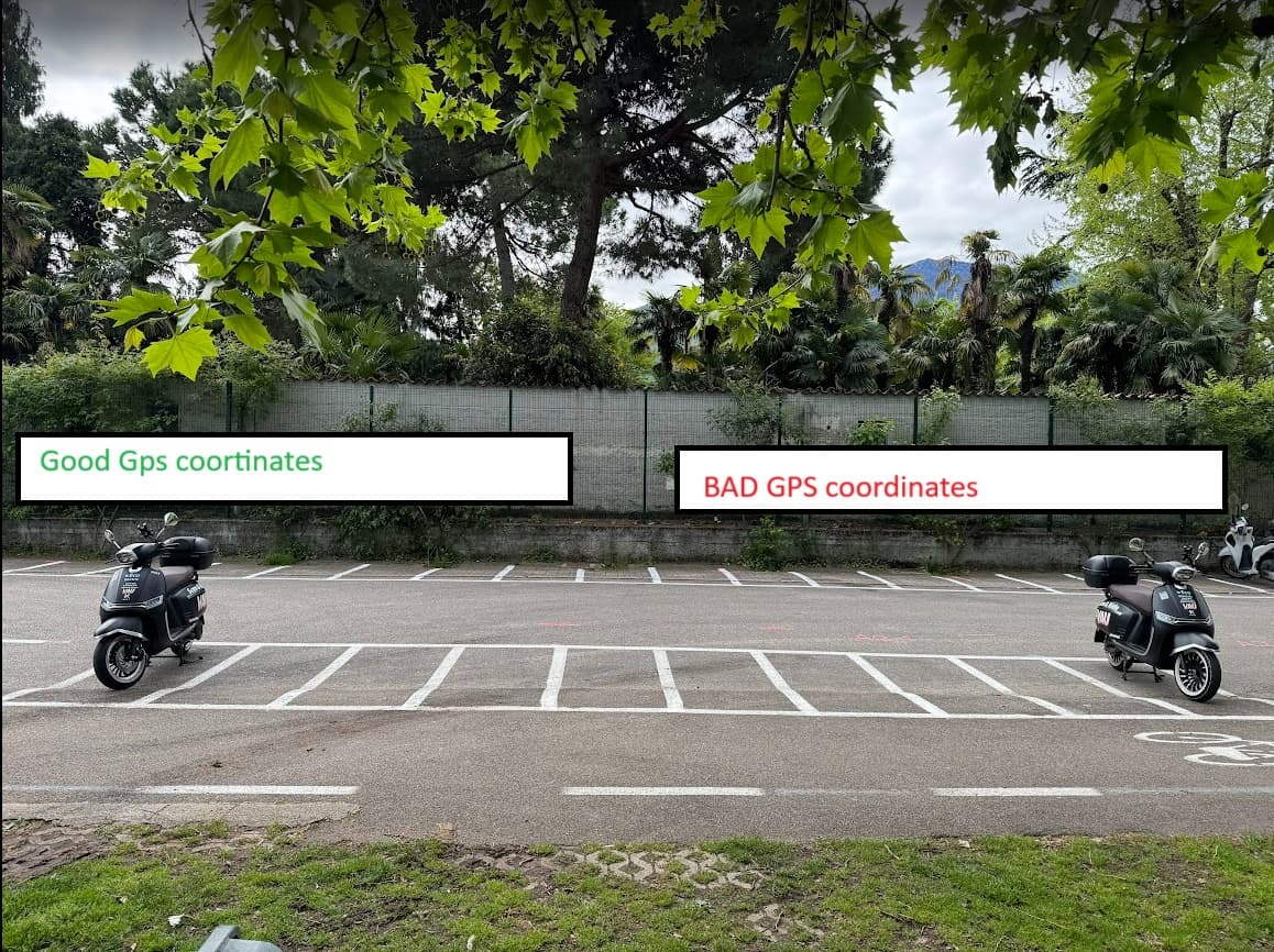

We operate a fleet of identical vehicles equipped with Teltonika TFT-100 devices.
Problem Description:
GPS coordinate errors ranging from 40 to 70 meters.
The issue occurs on random device at unpredictable times.
The error can persist for over 24 hours before resolving itself.
Other identical devices nearby show accurate coordinates, ruling out interference or global GPS issues.
The issue occurs in open-sky conditions without any canopy or obstruction.
I hope you are doing well. As per my understanding, other TFT100 devices were working fine on the other same vehicles but the others are not working well.
I recommend you to check the installation whether the same position were applied on the other vehicles as Bad GPS coordinates might arise if there are metals near the device installation. On the other hand, you may also check on updating the device Firmware version to the latest one where you can access it on this link: Firmware versions - Teltonika Telematics Wiki.
