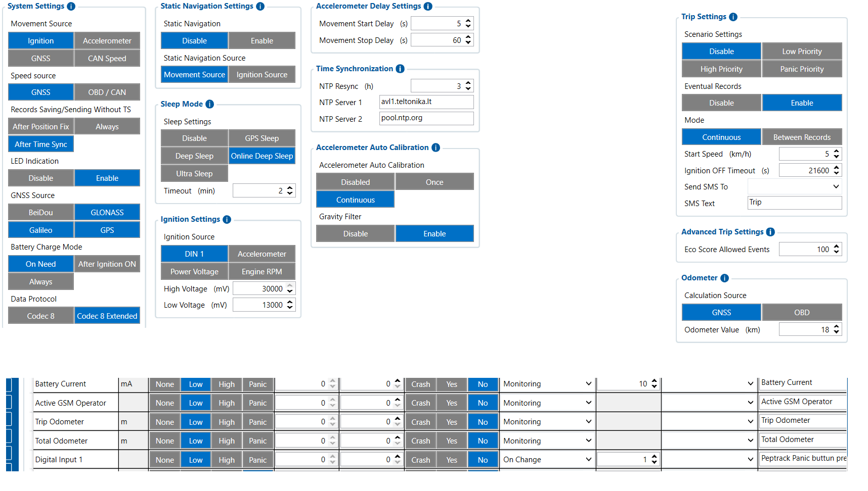

Hi Arnas
Can you please check if my configs are correct to get the daily trip after every 6 hours of ignition off time.
Thank you
For a device to detect a trip, navigate to Trip Settings → Scenario Settings set to at least Low Priority. In Your case this detection is disabled. To be more specific which AVL ID would You like to obtain?
