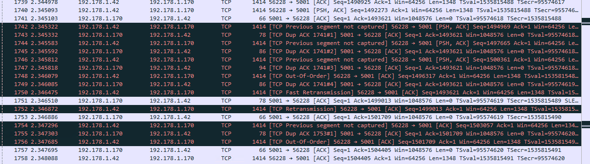

  • Monitor the network traffic using Wireshark (below picture was made on receiver side). You will notice frequent TCP retransmissions, especially with fragmented frames.
192.178.1.42: Device-A (Sender)
192.178.1.170: Device-B (Receiver)
