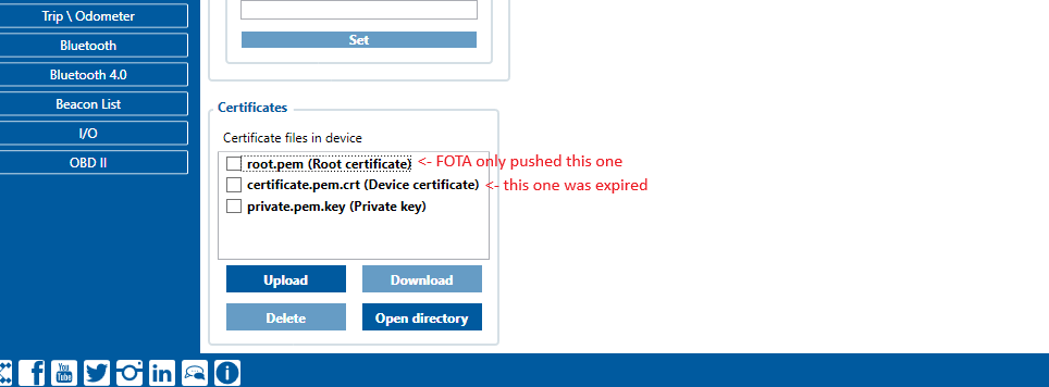

I have 3 files (root.pem, device.pem.crt, and device.pem.key), which were successfully uploaded using teltonika configurator USB. And all files are PEM formatted (contain -----BEGIN and -----END).
But, no matter which combination and permutation I use during uploading to FOTA, FOTA task only pushes root.pem (root certificate) to the FMC (verified by connecting teltonika configurator through USB and checking the Security->Certificate menu).
So, in essence, does FOTA web only support pushing root certificate? Does it not support the device certificate or its private key?

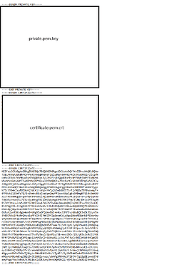

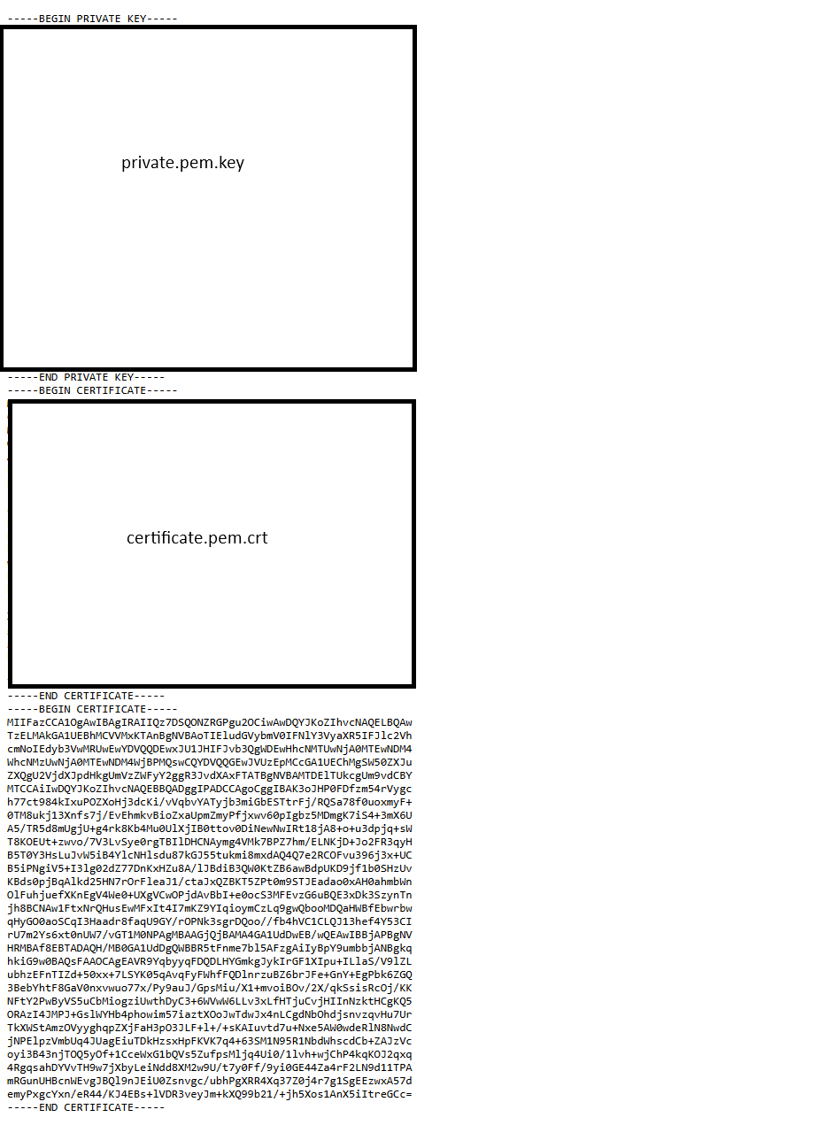

Based on your clue, I found the solution but only for blank or new device. To push device certificate through FOTA, I need to create just single .pem file with the specific order: private key → device cert → root cert.
Unfortunately our already deployed devices were using this guide Getting Started with AWS IoT Core - Teltonika Telematics Wiki, which splits the certificate into 3 files (root cert, device cert, and private key).
Based on my testing, the following certificate.pem.crt also needs to be pushed from FOTA, or deleted entirely along with the private.pem.key file, for client cert TLS to works.

Remote removal of the certificate via SMS or via fota, is not available if the certificate was uploaded through USB or Bluetooth.

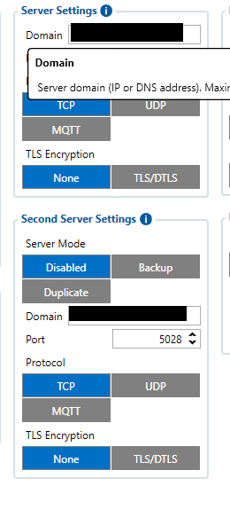

  1. First, disable TLS in the configuration file and upload via fota. Alternatively, you can disable it using the following SMS command:
    SMS_login> <SMS_password> setparam 2020:0;

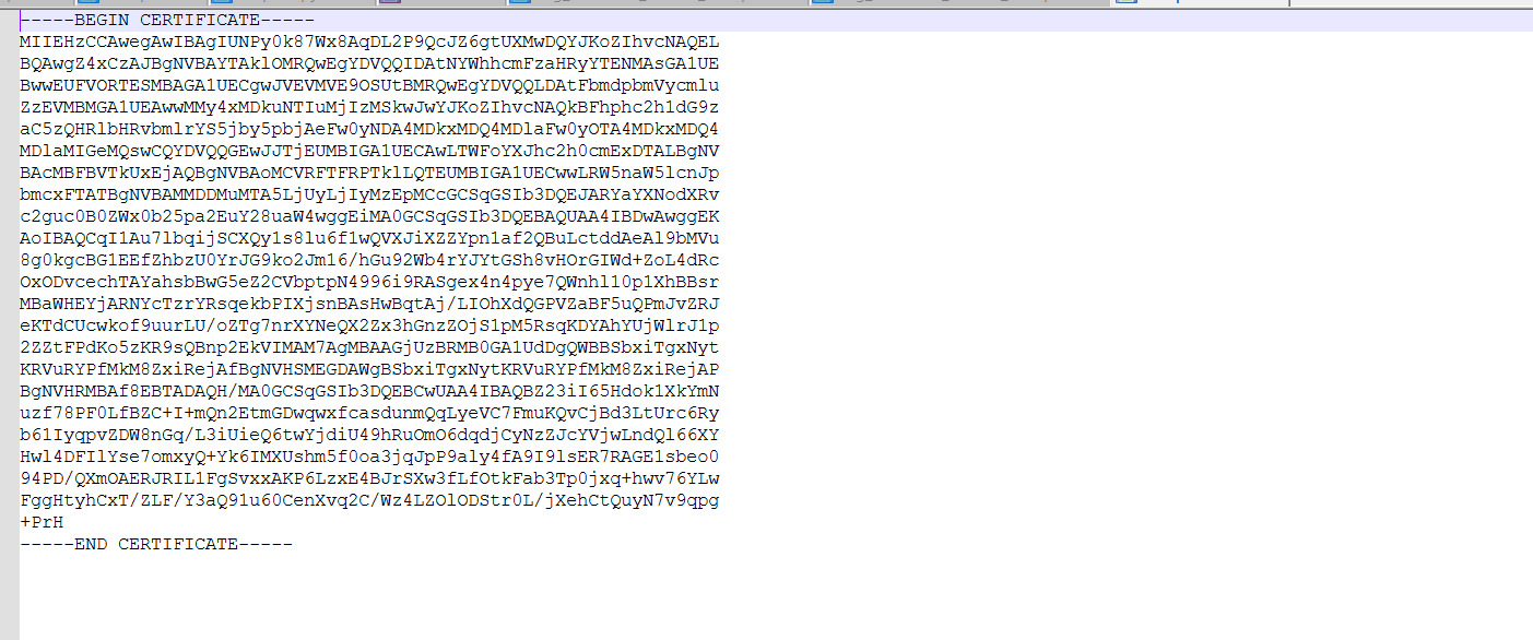

  3. Prepare a single root.pem certificate containing all the required certificates combined.
  4. Upload this certificate via FOTA and check whether the device connects and works correctly.

Using the testing device, via SMS, I disabled TLS on both the first and second servers.
Then through FOTA, pushed the single-file certificate.
However, the expired certificate still persisted, and TLS remained non-functional.
