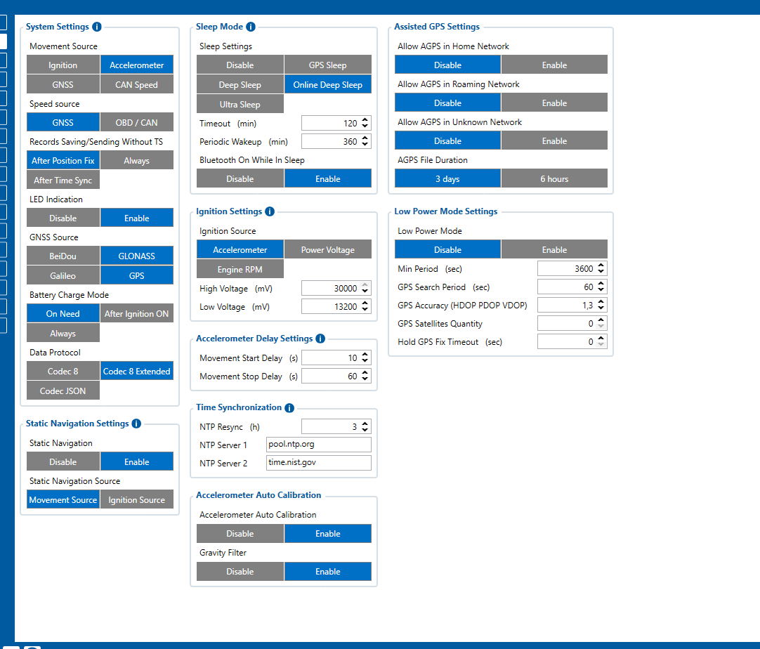

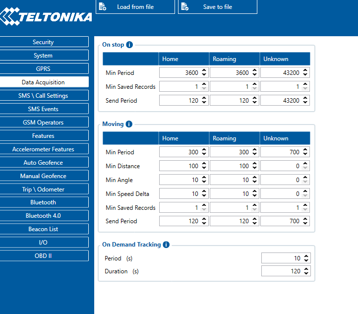

I am using the Data Acquisition in “Unknown” mode (see screenshots).
A ping should come in every 700 seconds (Driving)

I hope you are doing well. The data from the device seems to be fine, if you want to received data from the device for On Moving in every 700 seconds then you need to set Min Period and Send Period to 700 seconds.
On the other hand, keep the Min Distance, Min Angle, and Min Speed Delta to 0 seconds. For more information you may refer to this link: FMT100 Data acquisition settings - Teltonika Telematics Wiki

Hi Patrick, thanks for your fast response!
I am not sure if I get your message right - if you look on my provided screenshots I already set those two parameters to 700.
Anyways I get multiple messages nevertheless.

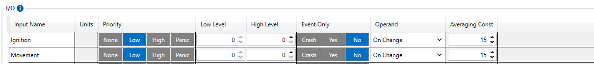

I can see that Ignition toggles 4 times. Maybe it has to do something with that?
Maybe I can disable it?
Hello @czaded,

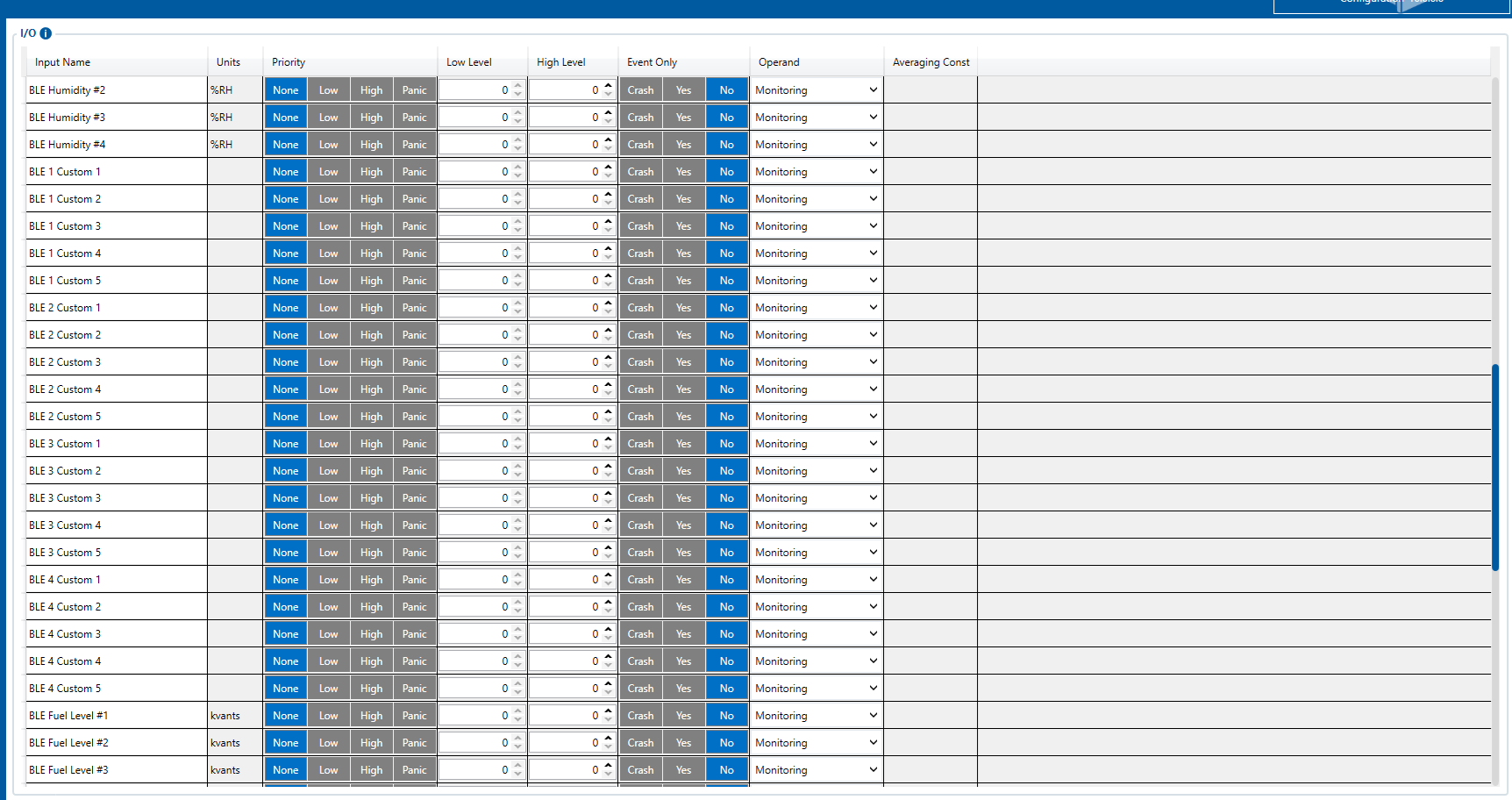

Thanks your for your feedback. I missed the Unknown comment above that you were using it. If that’s the case, it seems that the other Features and parameters causes the data trigger.
On the other hand, if you want to limit the Ignition toggling, you may change the Operand from Monitoring to On Change.

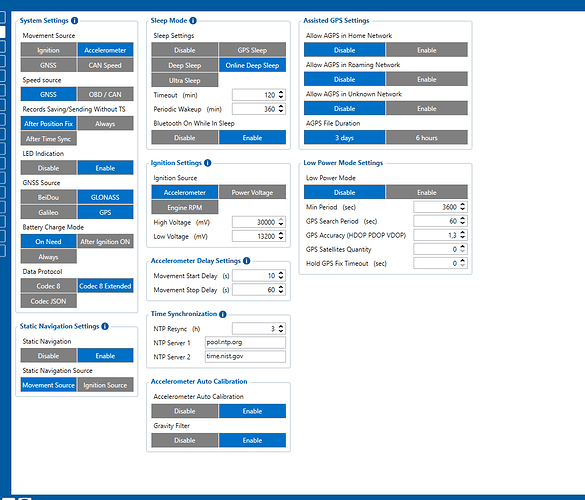

So I dont know why exactly but after a lot of trial and error I came up with this config:
This solved my issue
Also set I/O Ignition / Movement to:
