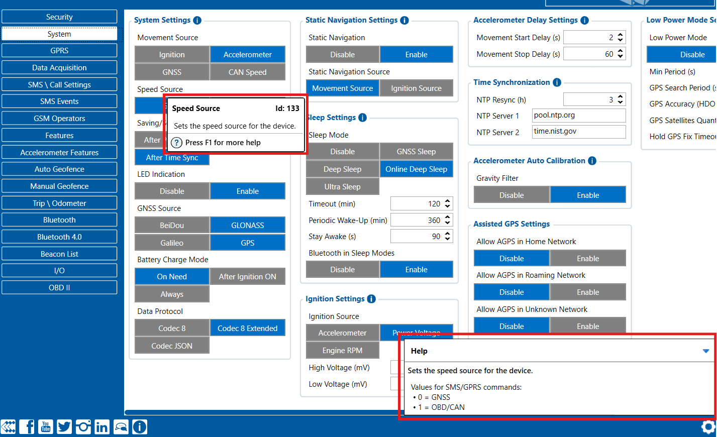

Thank you for using our community page.
Currently, there is no new page for parameter list being release yet. As an option, to check the current parameter ID, you may look for the parameter ID in teltonika configurator by hovering your mouse to the desired parameter. Additionally, you may press F1 key on your keyboard and further explanation will be appear on the bottom right corner of the configurator window.

Hi Muaz. That is perfect and works. Thank you
