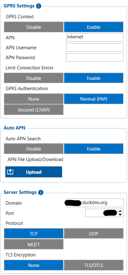

Here is my FMC920 configuration:
Thanks for showing me your settings.
My confirguation has been the same, and I’ve tried a variety of others.
I got a reply from a Teltonika staff and they suggested to try to swap the SIM cards. It turns out, the SIM I got for this FMC920 (Lemon Mobile) is at fault as when I placed my JB Mobile SIM from my phone into it, it worked immediately.
Thanks for replying. I’ll mark this as solved.
