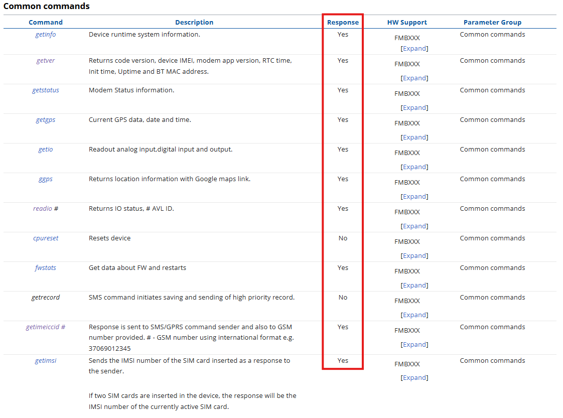

Hello @PAULO,
Good day! Device would not respond if you have sent “cpureset“ command.
Such information is available in the SMS/GPRS Wiki Page of the FM device. For more information you may refer on the screenshot and link below.
SMS Wiki: FMC920 SMS/GPRS Commands - Teltonika Telematics Wiki
