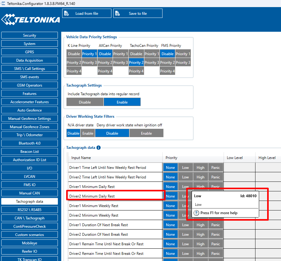

I’m having trouble finding the correspondence between the FMC640 Data Sending Parameter IDs and the FMC640 Device Family Parameter List. I need to enable all Tachograph data elements, but not all of them have a Parameter ID listed in the documentation.
For example, I cannot find the corresponding ID for 10524 - Driver 1 Minimum Daily Rest, and the same issue applies to many other parameters. Without knowing the exact Parameter ID, I’m unsure how to activate them properly.
Has anyone encountered this issue before? Is there a way to enable all Tachograph parameters without manually specifying each ID?
Thanks in advance for any advice!
Good day, please find the details below:
  1. You can find the data sending parameters on this link: FMB640 Teltonika Data Sending Parameters ID - Teltonika Telematics Wiki
  2. Parameter ID can be identified using configurator, if you want to know the parameter ID just put the mouse under the parameter that you want and then the parameter ID details will appear.
