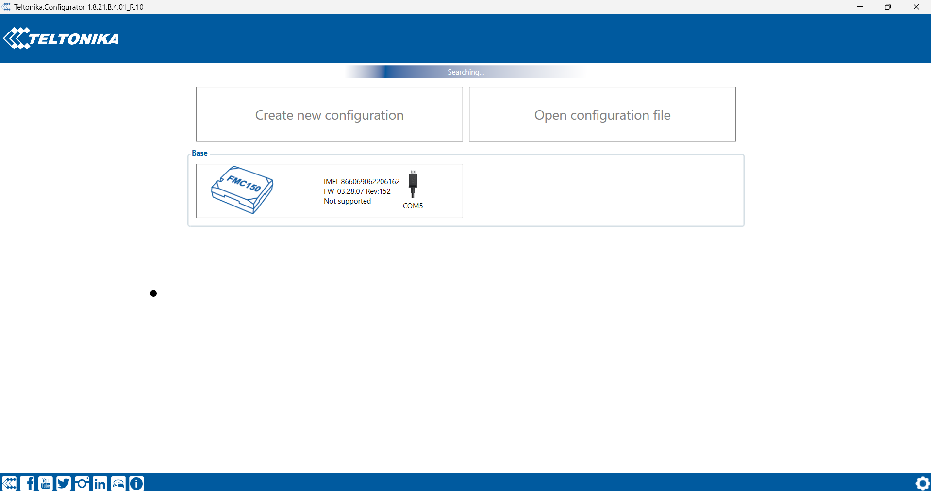

FMC150 detected in Configurator, but shows “Not supported” on firmware 03.28.07 Rev.152
I am trying to access and update an FMC150 with firmware 03.28.07 Rev.152, but all public Configurator versions I tested show the device as “Not supported”.
Device information:
  • Model: FMC150
  • IMEI: 866069062206162
  • Firmware: 03.28.07 Rev.152
  • USB connection / COM5 detected
Tested Configurators:
  • 1.8.21 B.4.01 R.10
  • 1.7.74_E.FMX150_R.16
In both cases the device is recognized correctly, but it cannot be opened because the Configurator reports “Not supported”.
This suggests the problem is not related to drivers or USB communication, but to a mismatch between this firmware version and currently available public tools.

Good Day,
Could you please try using configurator version 1.7.74_E.FMX150_R.16 ? You can download it from the link provided below, as it may support devices running older firmware versions.
If the issue still persists, I recommend opening a helpdesk ticket via your partner portal.
Our team will assist you in providing the exact configurator version required for your device. Please note that, due to policy, we are unable to share files directly on community platform. If they are not available on public/wiki links.
