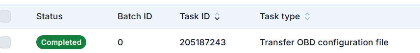

First, could you please check from FOTA whether the FOTA file transfer is completed successfully, as shown in the example below?
If the FOTA file transfer is successful and you are still not receiving any vehicle data, I suggest using the latest firmware version available from the link shared below.
