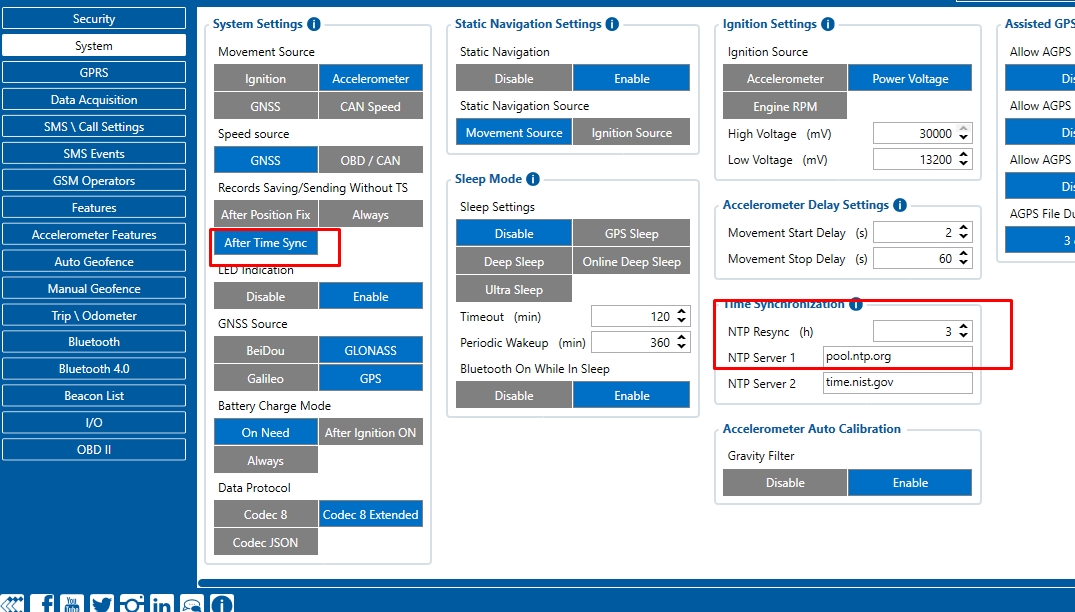

I configured it the same way as you. Now, I just changed the time server. I will write the result here.
My NTP server configuration is the same as yours, but I receive an invalid time on the data received by the server.
The received time is about 30 minutes ahead of the current time!

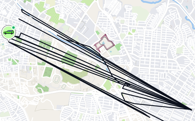

Upon further review, I realized something. The location data has the correct time, but the position is incorrect! For example, let’s say we have three geographic points, where points 1 and 3 have both the correct geographic position and time, but point 2 has the wrong position, although the time is correct! On the other hand, although the server time is working correctly, the device is several minutes (sometimes even hours) off, and after a while, it automatically corrects itself!
notice that the point 2 is where device was there several hours ago
Last Data We Received From Device Today!

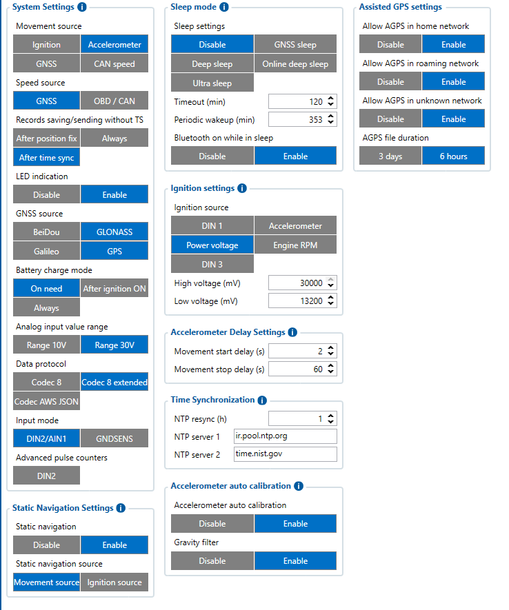

This is my configuration

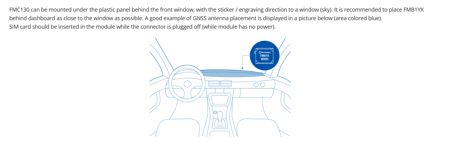

Please check how many satellites are available from the configurator. if you receive fewer satellites, try to change the location of the device.
Make sure that you have follow the correct device installation: FMC130 First Start - Teltonika Telematics Wiki

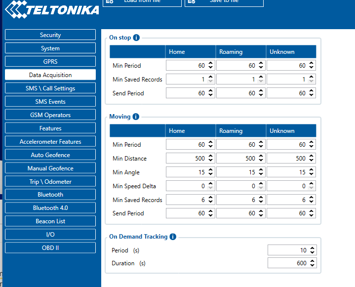

Try to test the data acquisition settings below
Ignition source should be DIN 1 . DIN 1 should be connected to the vehicle ignition cable
