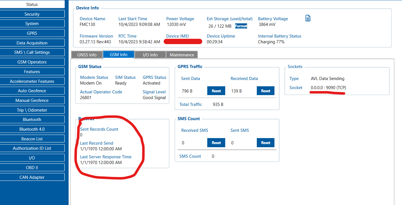

Hi there. I have 2 FMC 130, and on both of them, i’m not getting records. It sends the handshake, i reply with 01, but no records what so ever.

Im using Codec 8 since the beginning and always worked. And, even though if it was bad reply from the server, shouldn’t the record count be higher than 0 on the configurator?

Did that, but still no records.

maybe in your location there is no GPS signal that is why the device is not generating the records try to use the Always
Already have that setting.
In this case, the issue is in your server have you tried to connect another platform to the device?

Ok, now flespi seems to work perfectly. Do you have any idea why is not working with my server?
It’s resolved. Thanks for the help!
