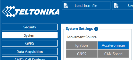

I hope you are doing well. Could you confirm which Movement Source you have set on the device Configuration settings? You may set it as Accelerometer so the device would detect Movement based on its internal sensor and not on change of GNSS data.
On the other hand, device would exit Sleep Mode once Movement/Ignition is detected from the device. Are you testing inside Office, I recommend you to test the device with an Open sky so the device can detect good GPS data.

Thanks for you quick reply. Yes I have Ignition, movement & GNSS activated for movement & makes no difference. This seems to be a common issue that I have with 965’s, the only way I can reliably overcome it is by having sleep settings disabled. It feels like a software issue somewhere as i’ve never had issues with FMT100, 920 or 204 models. Thanks Nigel
