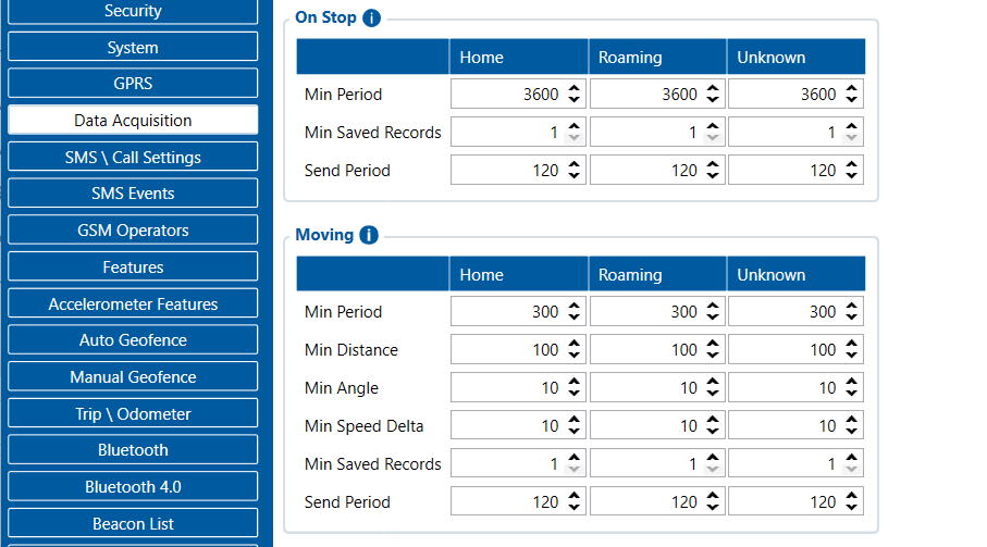

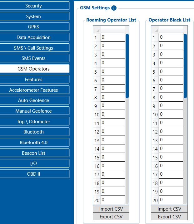

Secondly, I suggest you check the operator codes with the SIM provider and add them to the GSM Operator List tab for roaming. Also, make sure the required operator codes are not added to the Blacklist Operator settings. Based on that operators, you can set the data acquisition time interval for different home, roaming and unknown mode.

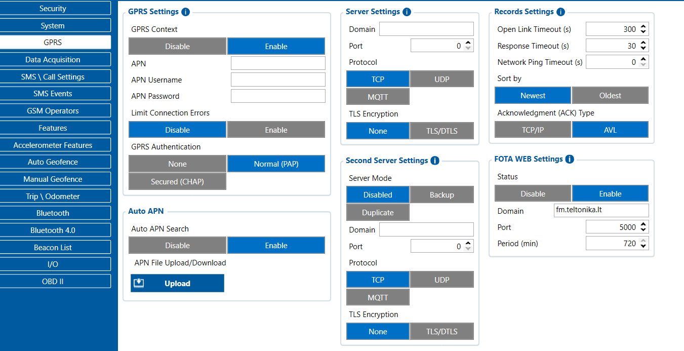

Thirdly, from the GPRS Settings tab, disable the Limit Connection Error setting, reboot the device, and then check the behavior.
If you still face any issues, I am sending you the snippet for your reference.
