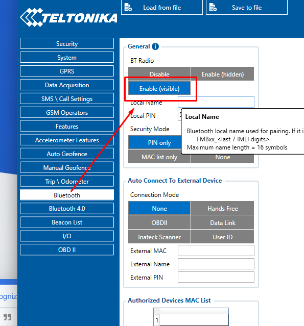

Note: Bluetooth will only show once you enable it.
