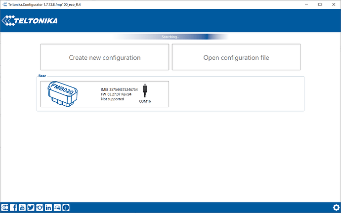

Hi I’m trying to configure a FMB020 I followed the instructions from the website to install the device.
I have the following issue when opening the configurator, the device is seen but reports that it is not supported.
I try configurator version is
Teltonika.Configurator_1.6.4_E.FMP100_R.1
Teltonika.Configurator_1.7.21_E.FMP1_R.6
Teltonika.Configurator_1.7.72_E.fmp100_eco_R.4
it reports firmware 03.27.07.Rev.94
Please help
See attached images
Please download it here: https://wiki.teltonika-gps.com/view/Special:Redirect/file/Teltonika.Configurator_1.7.22_E.fmb003-002-020_R.104.zip
Check this link to download the configurator versions: Teltonika Configurator versions - Teltonika Telematics Wiki
Best Regards
Maynard C
works
thanks
